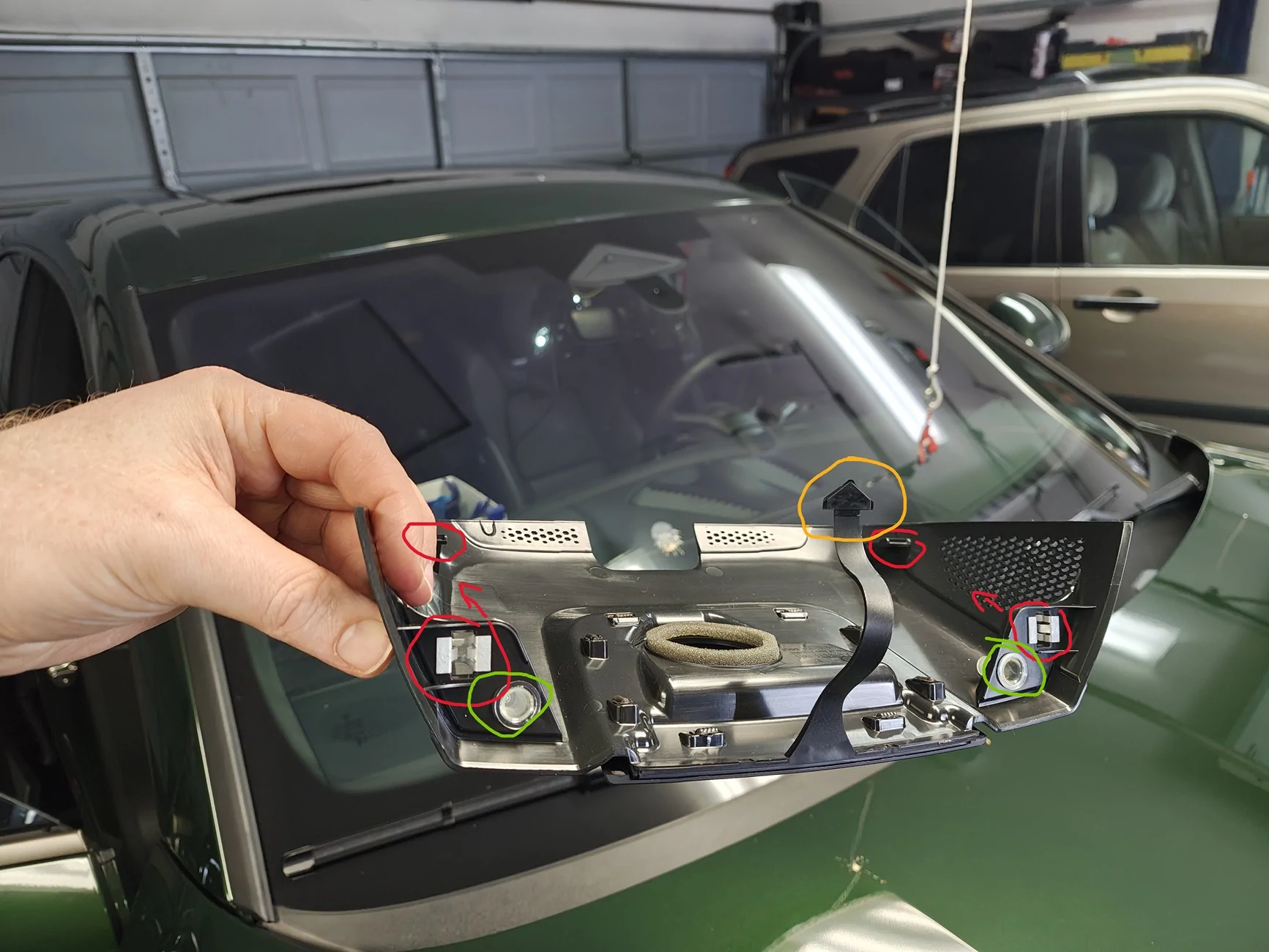

1 - Start by removing the forward part of the overhead console trim. Get two solid wide pry tools at the two green arrows and push towards the windscreen. You can do one side first, I think that is how it went for me. Needs quite a bit of force, be careful not to scratch/mark the trim.
Electric Macan EV FitCAMX Dashcam Install 1
This is the inside of that trim peice for reference on where the clips are. red are the clips, green is a sort of silicone/rubber guide, and yellow is a tether that holds the trim to the car in an accident :
Electric Macan EV FitCAMX Dashcam Install 2

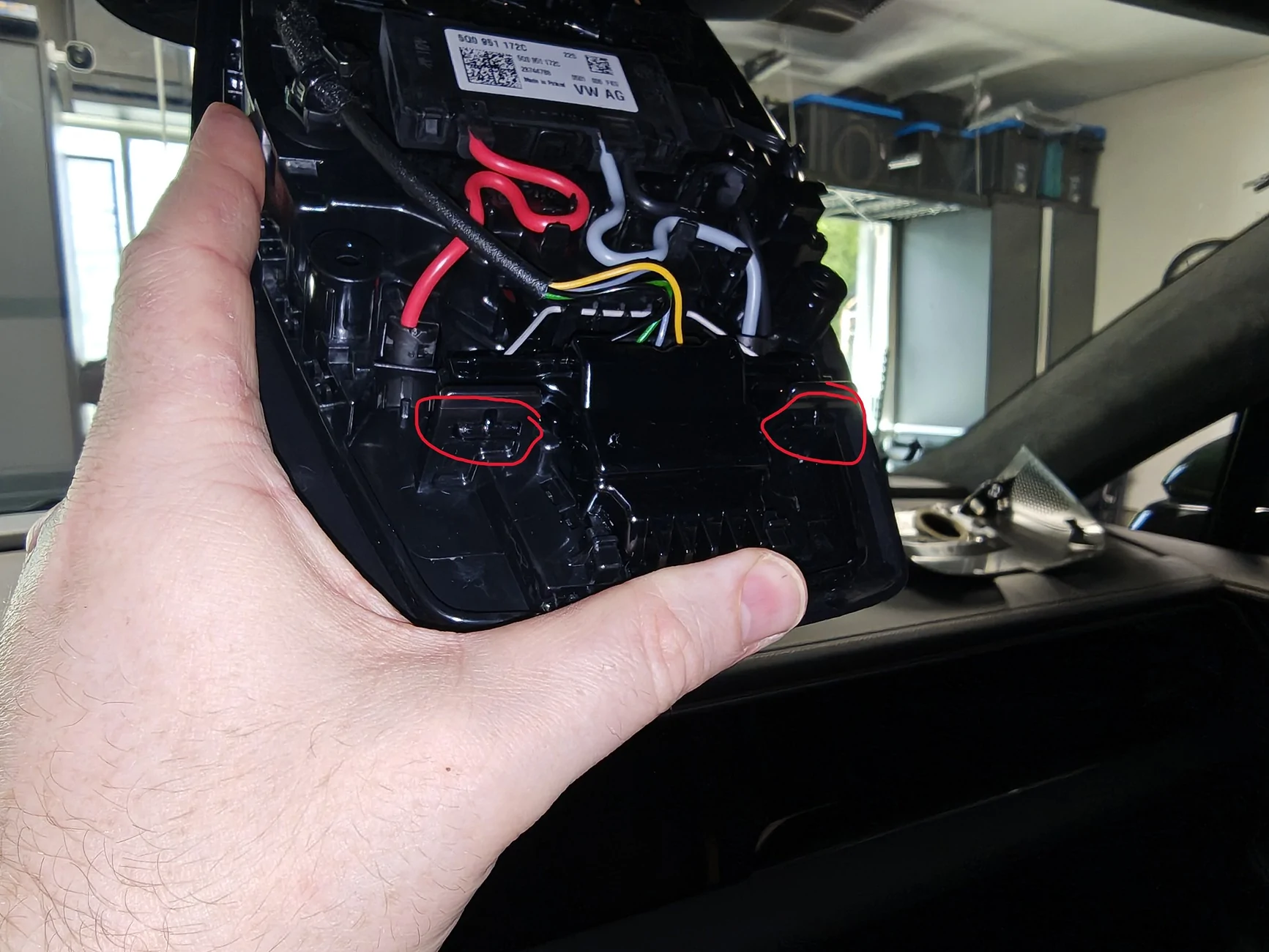

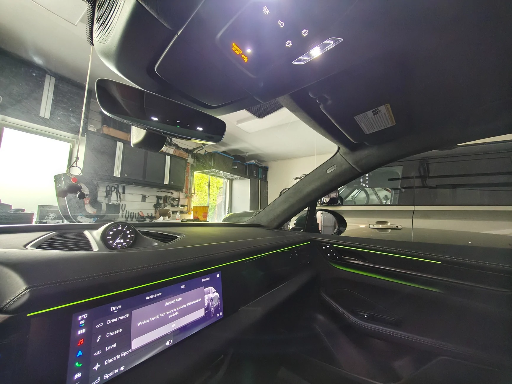

2- Lower the main overhead console. This is where that cayenne thread has bad information, do not start trying to pry it off, the outer trim can be removed, but you don't want to do that. the part labeled (1.) in the photo below is actually a spring loaded switch that pushes inward, it disengages the two tabs (2.). Just grab the larger metal pry tool from the set above, insert the flat end in the direction of the arrow and push the switch in. it does not need much force and disengages very easily when pushed correctly. The unit then swings down on a hinge and exposes the pre-wire connectors.
Electric Macan EV FitCAMX Dashcam Install 3
Electric Macan EV FitCAMX Dashcam Install 4

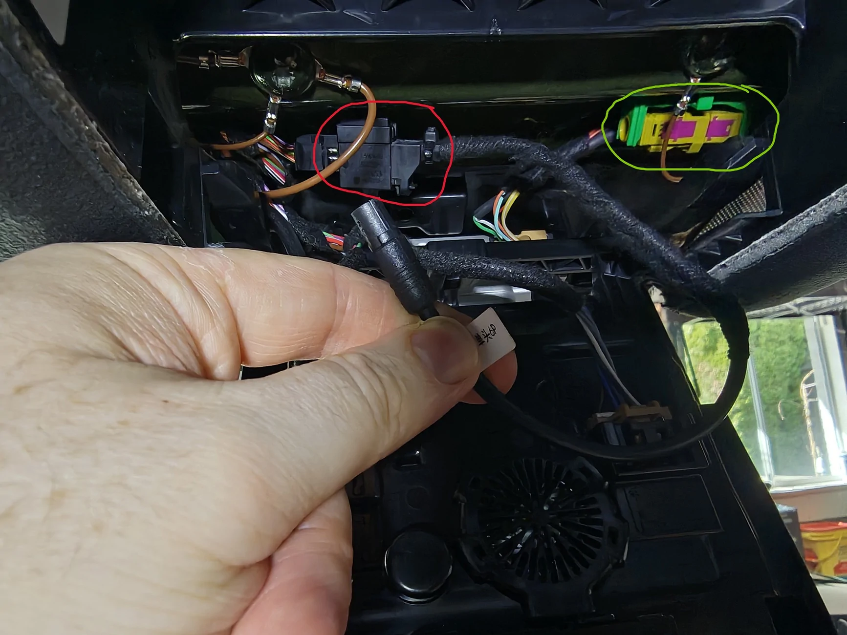

5- Connect the fitcamx -> porsche prewire adapter, and feed it and the rear camera connector through to the main overhead console. There is plenty of room, and the adapter is the perfect length. highlighted the pre-wire connector in the car in red, the fitcamx adapter clicks in very easily. the green highlight is the rear camera FAKRA connector, we won't need to use this.
Electric Macan EV FitCAMX Dashcam Install 9

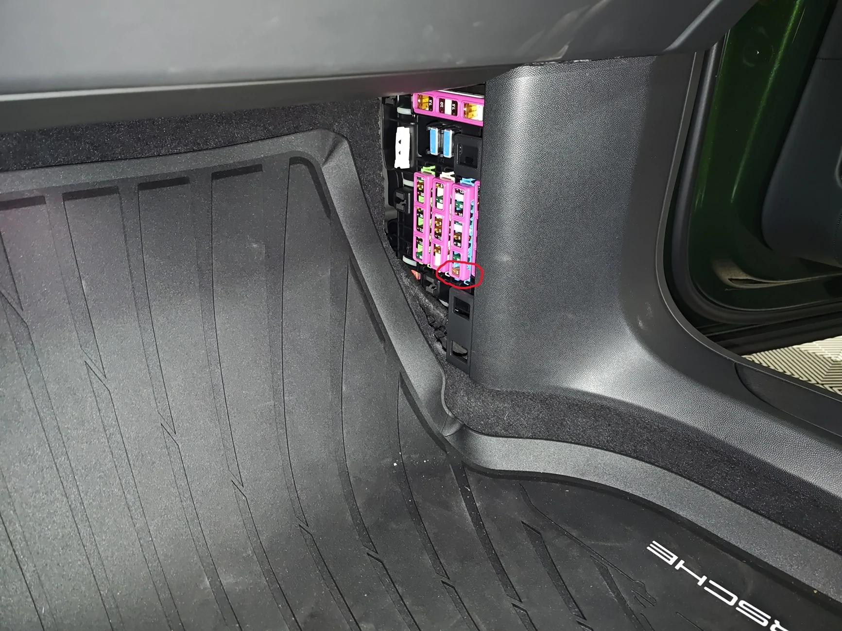

6- Install the dashcam fuses as per the official porsche prewire instructions here : https://static.nhtsa.gov/odi/tsbs/2024/MC-11011672-0001.pdf. the 5A fuse box is located in the passenger footwell, very easy to access, i circled where the fuse goes. the 10A fuse goes in the fusebox in the frunk, remove the cover that is circled, it goes in slot 1 which is labeled, and there is a diagram of it's location in the instructions.
Electric Macan EV FitCAMX Dashcam Install 10
Electric Macan EV FitCAMX Dashcam Install 11

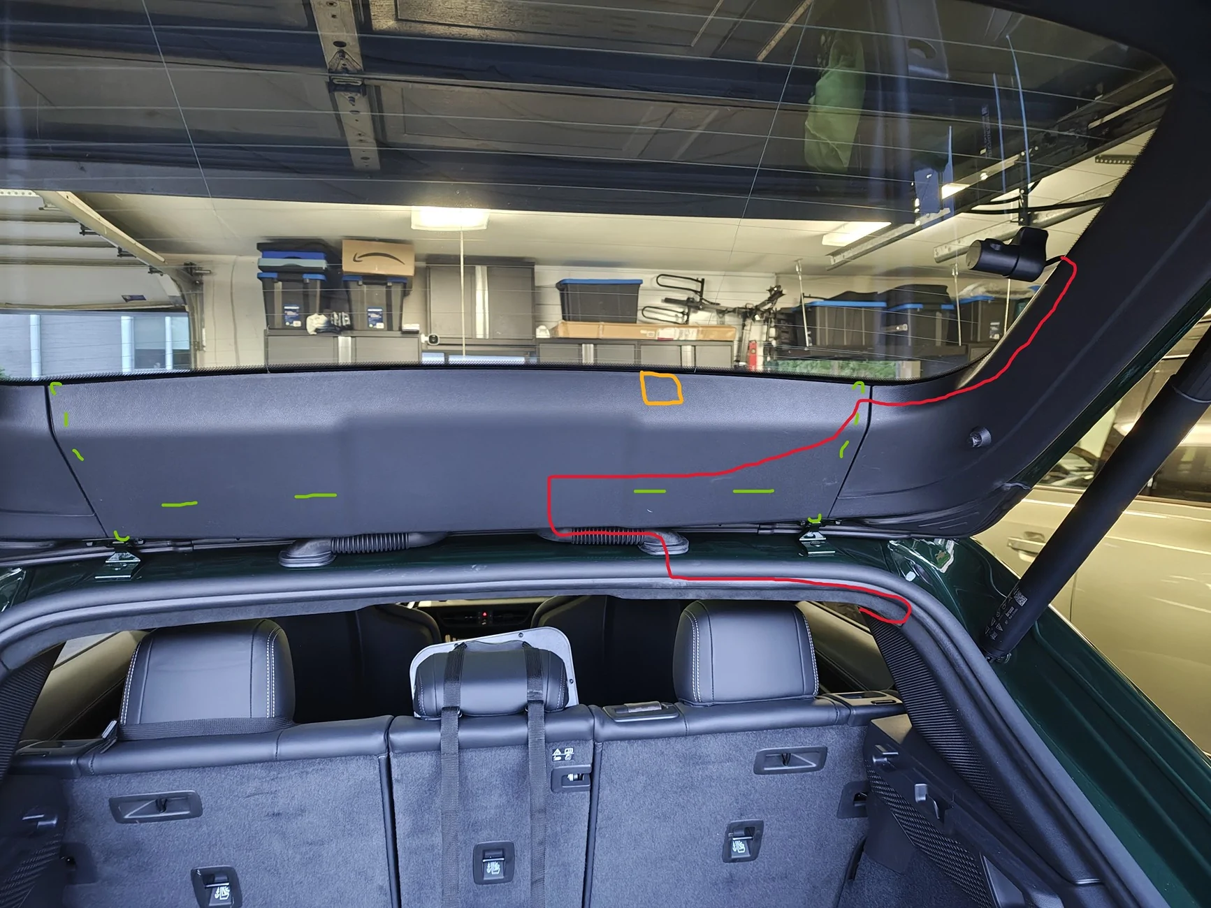

6- Run the rear camera wire along the passenger side of the car along the edge of the headliner. it tucks under the roof lining quite easily the whole way along. the B Pillar is a little fiddley, but quite straight forward. Given the rear pre-wire location on the side of the luggage compartment, there is no point to try and leverage it, it's faster to simply run the fitcamx wire. The only complication is getting it through the trunk door wiring channel. You'll need to pry off the rubber cover from the plastic base that is clipped into the frame of the car, do this for both ends of the channel. note to put these back after you pull the wire through you'll need to unclip the plastic base from the car, then pull the rubber channel back over the edges of the base, and finally clip the re-assembled part back into the car.
Now you'll need the wire pull here that's in the kit. with a pry tool you should be able to create enough gap to feed the wire pull up into the hole, then pull the camera wire through. no need to actually lower the headliner here like in the instructions. do the same trick to pull the wire through the rubber channel as it's pretty tight. Then you'll need to remove only the top trim from the hatch. photo shows the path of the wire in red, and the green dashes are where the clips are on the top trim. note that each corner has a sort of plastic hook/lip that wraps around the trim peices next to them. you'll need to bend the corners outward to disengage the hooks before starting to pull. clips on the sides are plastic, clips in the middle are metal.
Electric Macan EV FitCAMX Dashcam Install 12

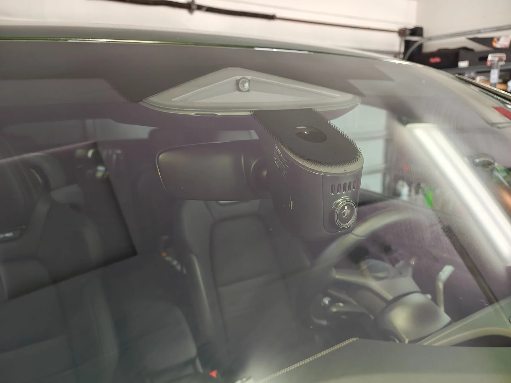

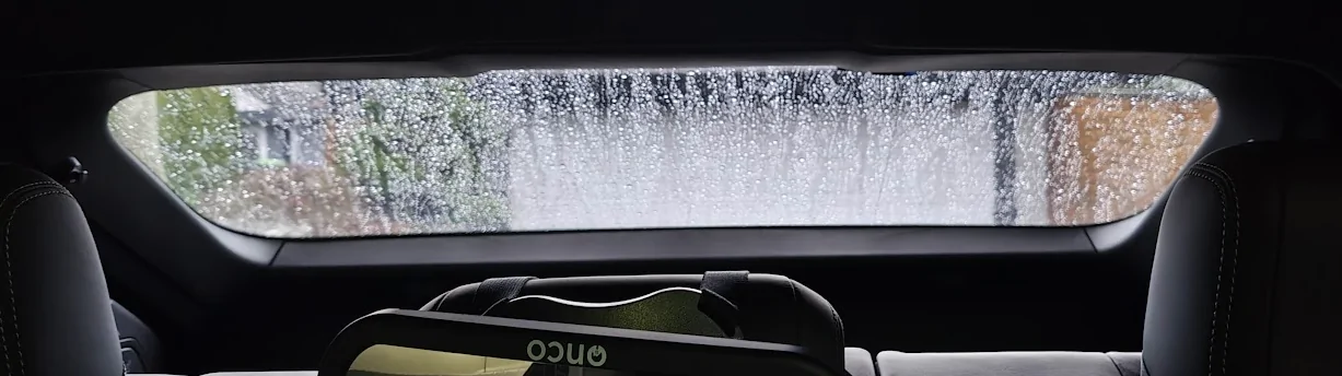

That's about it, after you choose a spot to place it, just bundle up the excess wire and pop it behind that top trim with some foam/cloth tape to stop rattles. I chose to install the rear camera here as it's as high as it can be while being completely hidden behind the rear headrest. The rear visibility is already bad enough in the macan, didn't want to compromise that. Do note as the glass is curved here, the camera will be at a slight angle and not quite centered, but it does the job. I was more worried about the looks/position of it not annoying me than the video quality.
Update: realized you can mount the camera on the top plastic trim itself (yellow square), up against the glass, and it is almost completely hidden in the rear view. Drivers side hides it a little better. This also means you don't risk damage to the defrost wires if it ever needs removed.

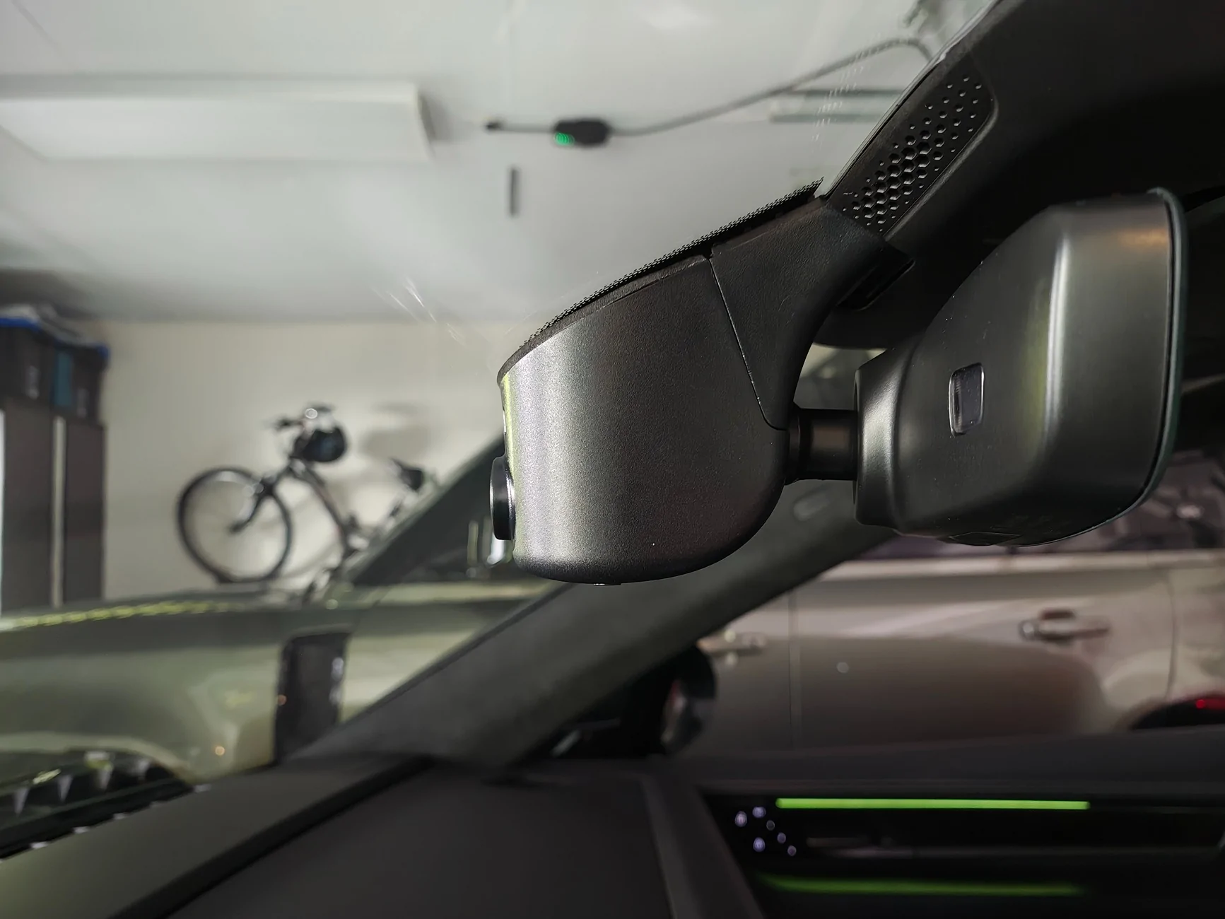

Finished product below :

I went with the Blackvue 2 channel so routing the rear is super easy. It sits up high in the middle and isn’t visible from the rear view mirror. My only gripes are that the front camera is big so it’s not very discreet and the power situation, I never figured out a year ago. Ended up going with the OBDC power adapter which works great for parking mode. No errors or alerts from the car but the Blackvue does alert me of low voltage drop below 11.8V from time to time if I don’t drive the vehicle for a day.

The blackvue is better as a dashcam no question, I just wanted something discreet that works. Personally I'm amazed porsche hasn't come up with a built in solution that just uses the cars cameras like tesla, it's such low hanging fruit. Android automotive I think even has built in dashcam functions, it just needs the video signals.
Anyway, are you saying that if you put the rear camera up high enough it's not visible in the rear view at all? I assumed this wasn't possible :facepalm:. I think there was a spare 3M adhesive in the box, might have to move it if that is the case.

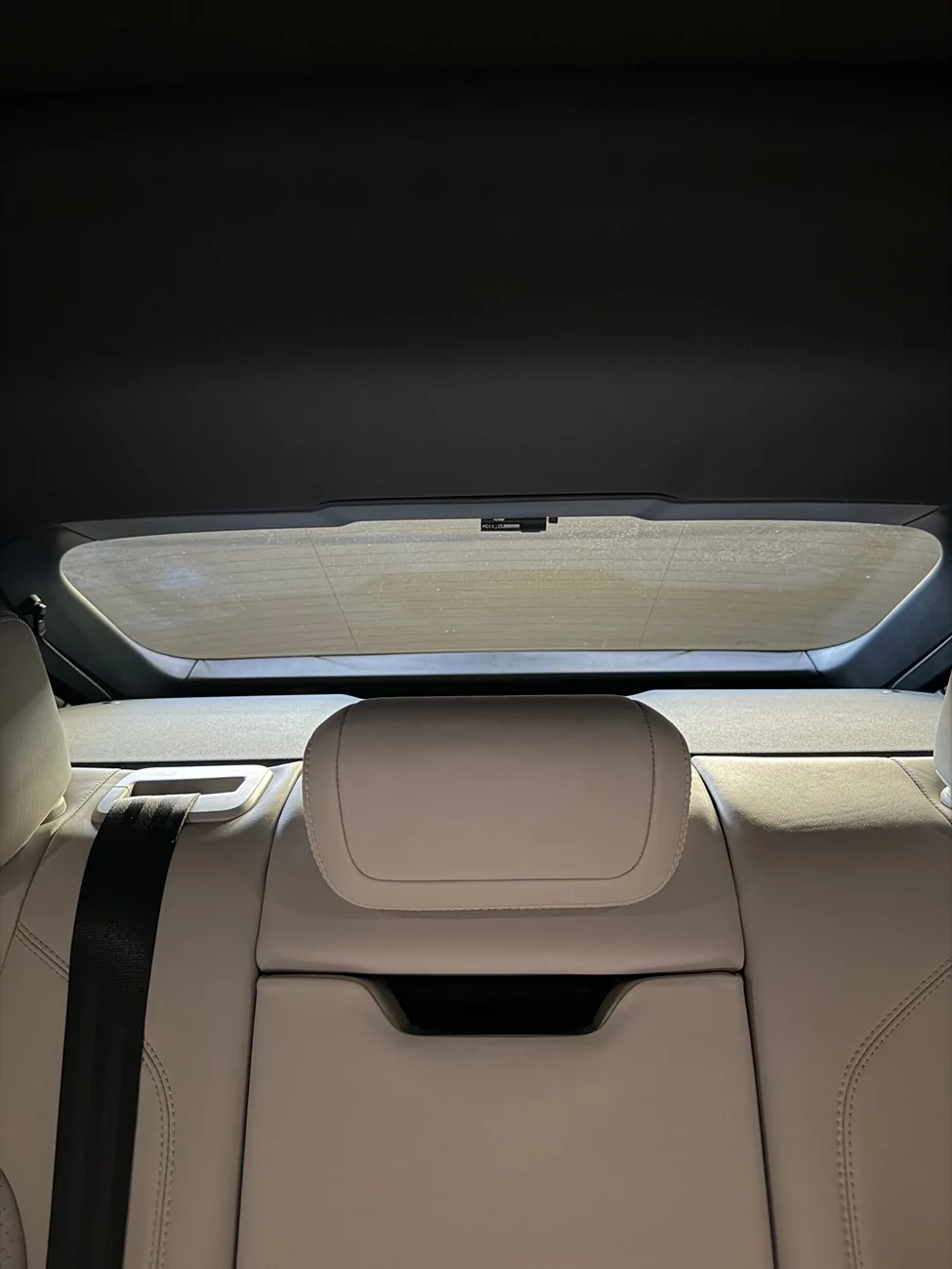

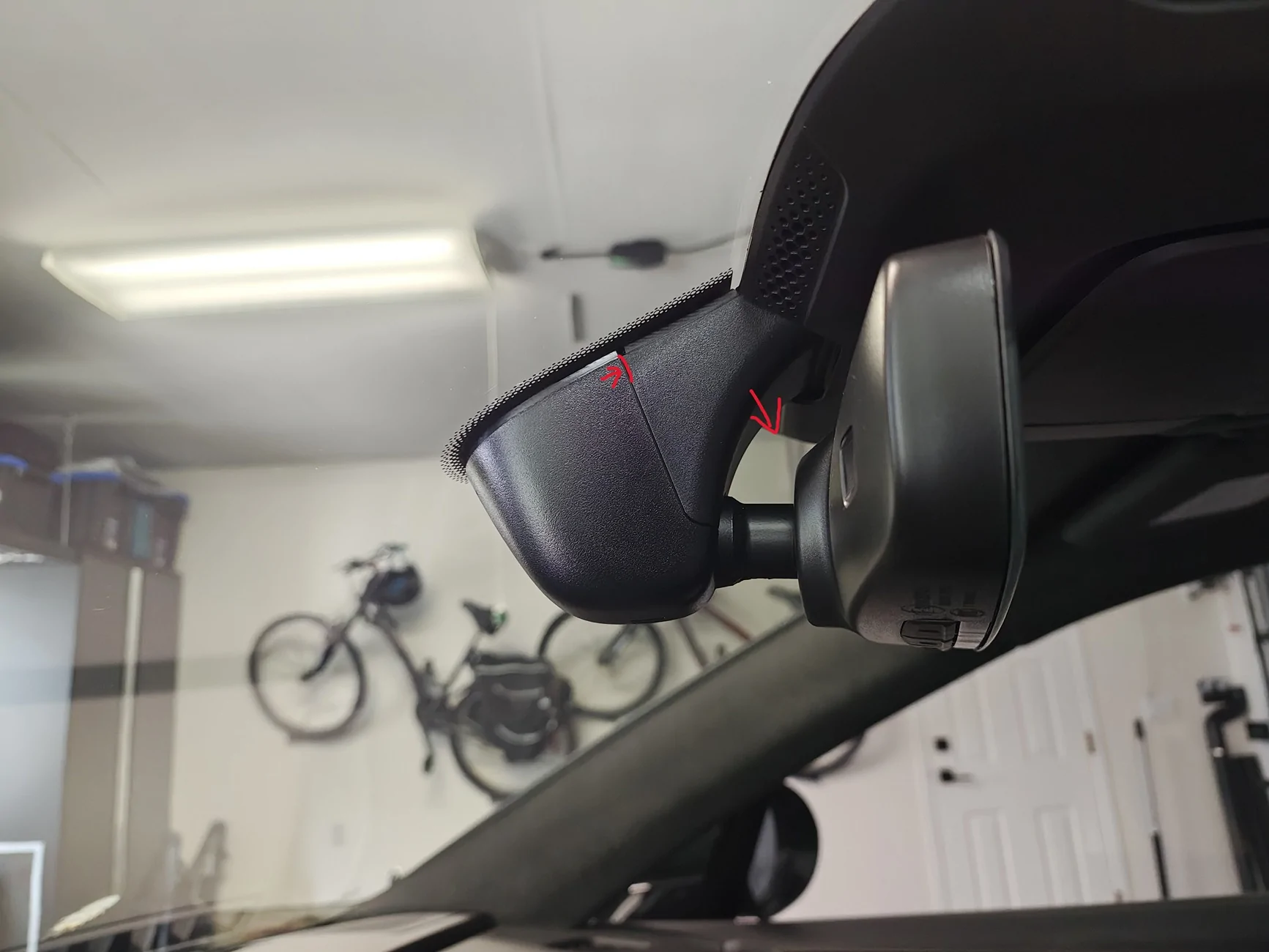

Looked again and it’s half seen. Compared to my Taycan that is using the DR970X Box, the front camera is small but the rear is huge and it’s fully visible in my rear view.
The Macan is the regular DR970X and the rear is smaller. It’s a few centimeters below the dot matrix but this is what it looks like looking back.

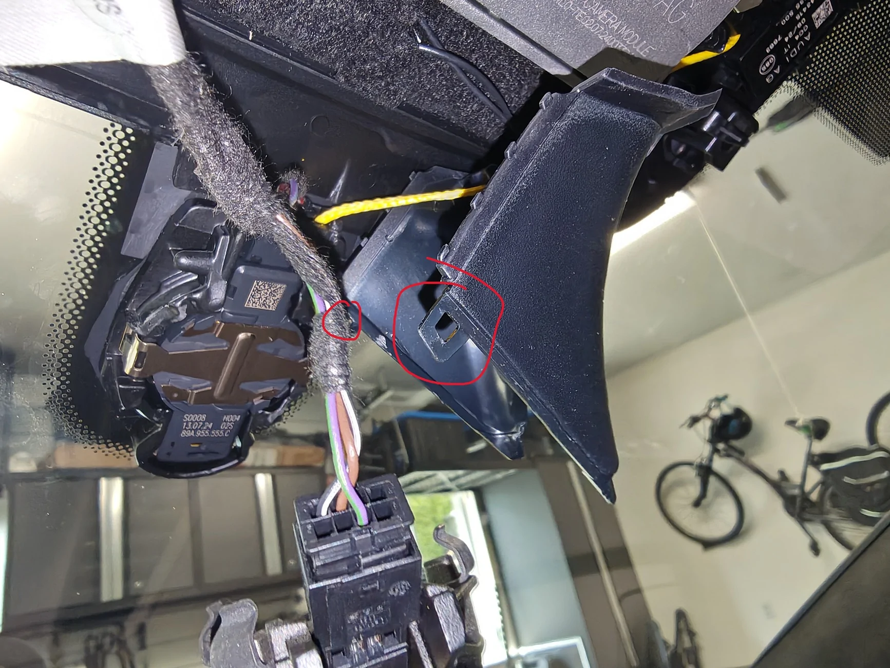

Great write-up, the best explanation I've seen of how to remove the overhead console so I may now give it a go wiring into the dashcam pre-wire socket.

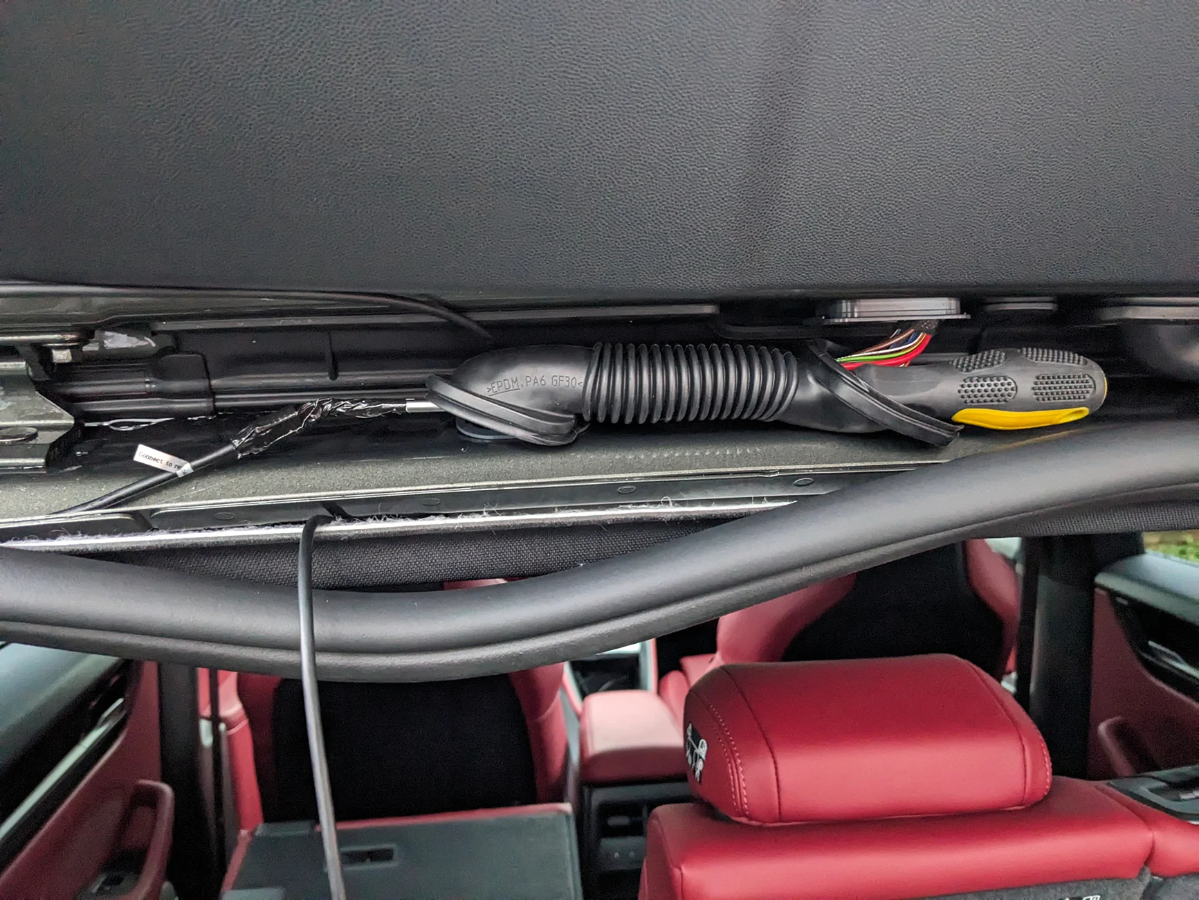

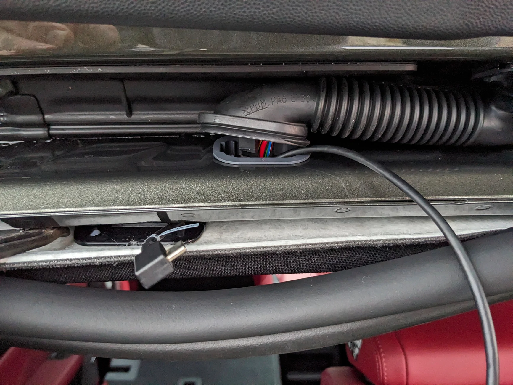

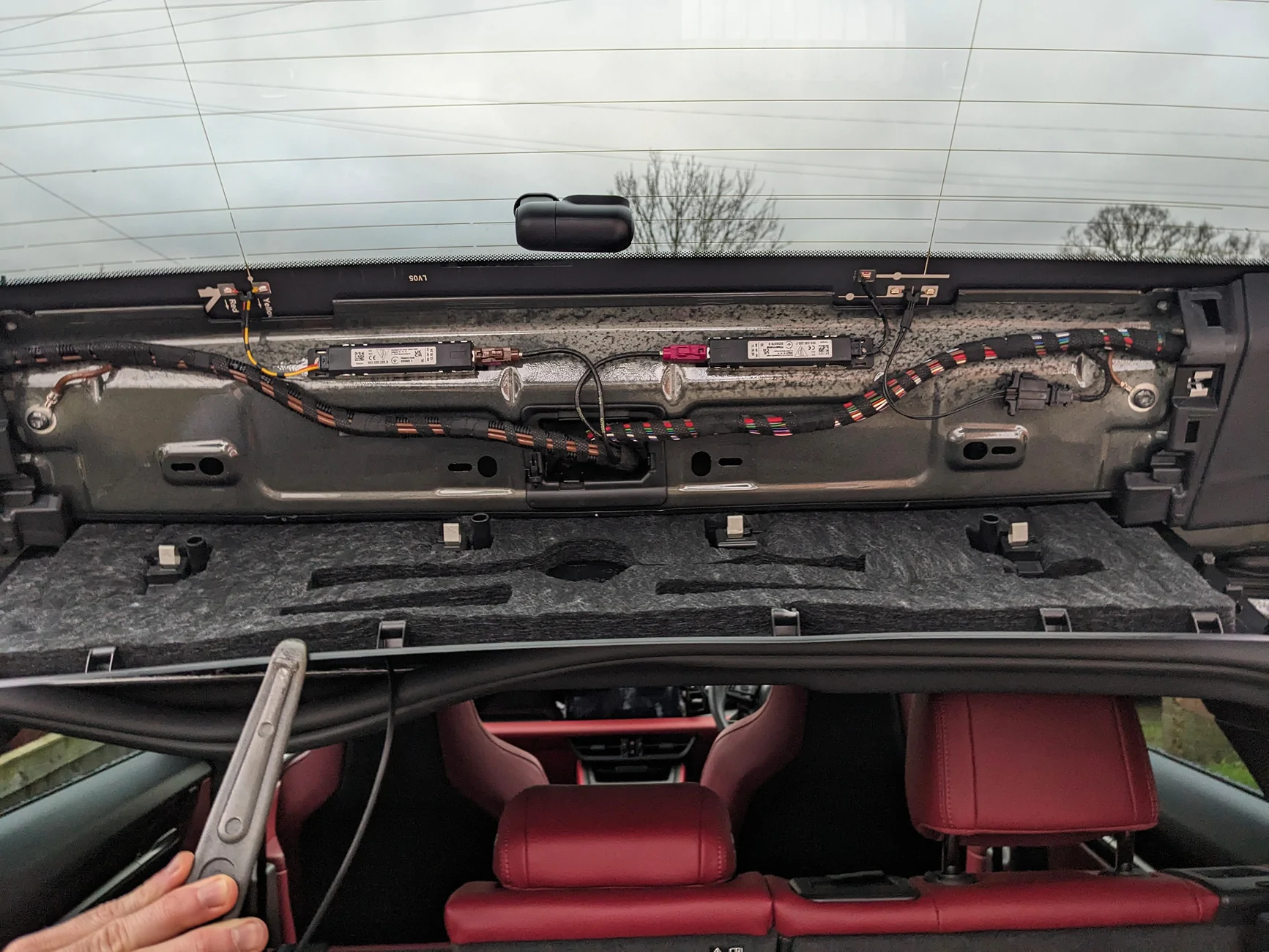

I include some pics from mine to show the tailgate panel clips for removal and alternate method for pulling the wire through the grommet!

Appreciate that! Looks clean, but you got me thinking. Looking back at my install photo above it looks like it could be mounted directly on the top plastic trim. Where it gets a little thicker off center, right up against the glass instead of on the glass. So back out to the garage, and it looks like that definitely works, and certainly gives a better viewing angle for the camera. you can just barely see it when looking back :

Wow now you got me thinking if I should change mine. I should have spare 3M pads, too. That looks good now. Good work!

Great write up. I installed just the front camera and tapped into the rain sensor. The image quality is not great but better than I expected. I like how stealth it is. I did add the polarizing filter after the fact and found it helps with the glare and the reflection off the windshield.
