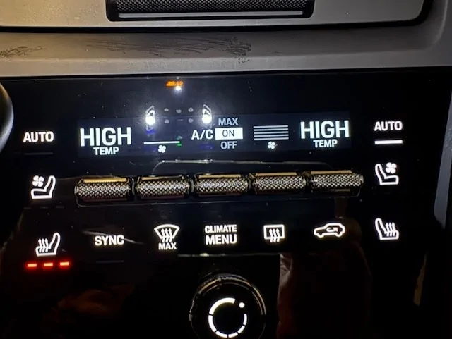

I assumed since there's no engine, an EV will generate heat right away when you turn on the heater but it took like 5 minutes of driving before I sensed warmer air coming in. Was hoping a benefit would be no longer having to wait for a warm engine but is this not the case with EVs?
. Try setting to max heat as shown. This setting heats up the interior in about 90 seconds (front vents open, fans on max and seat heat on helps get you through the 90 secs :)).
