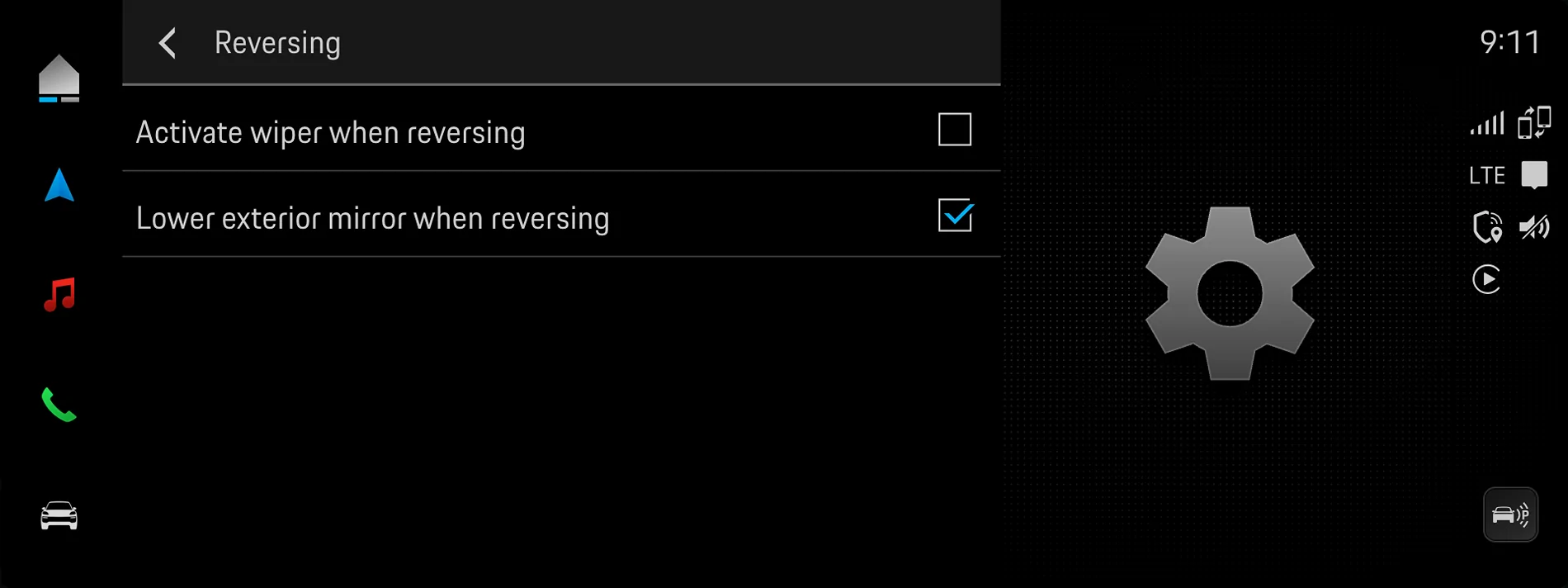

It is a doddle but poorly documented in the simulator (absent).
Go Settings --> Vehicle and then scroll to Light and Visibility --> Reversing
Electric Macan EV Tilting passenger-side mirror when reversing. 1753803400881-qc
To store the position press one of the memory buttons (use the one you have already set) whilst in reverse and the mirror tilted to desired position - this should address the misalignment.
Only the passenger side can be auto tilted for reversing - same as all other Porsches - you can of course programme a memory button to do both.
I don’t have this option to disable tilting on my 2025 turbo? Rly don’t like this feature.

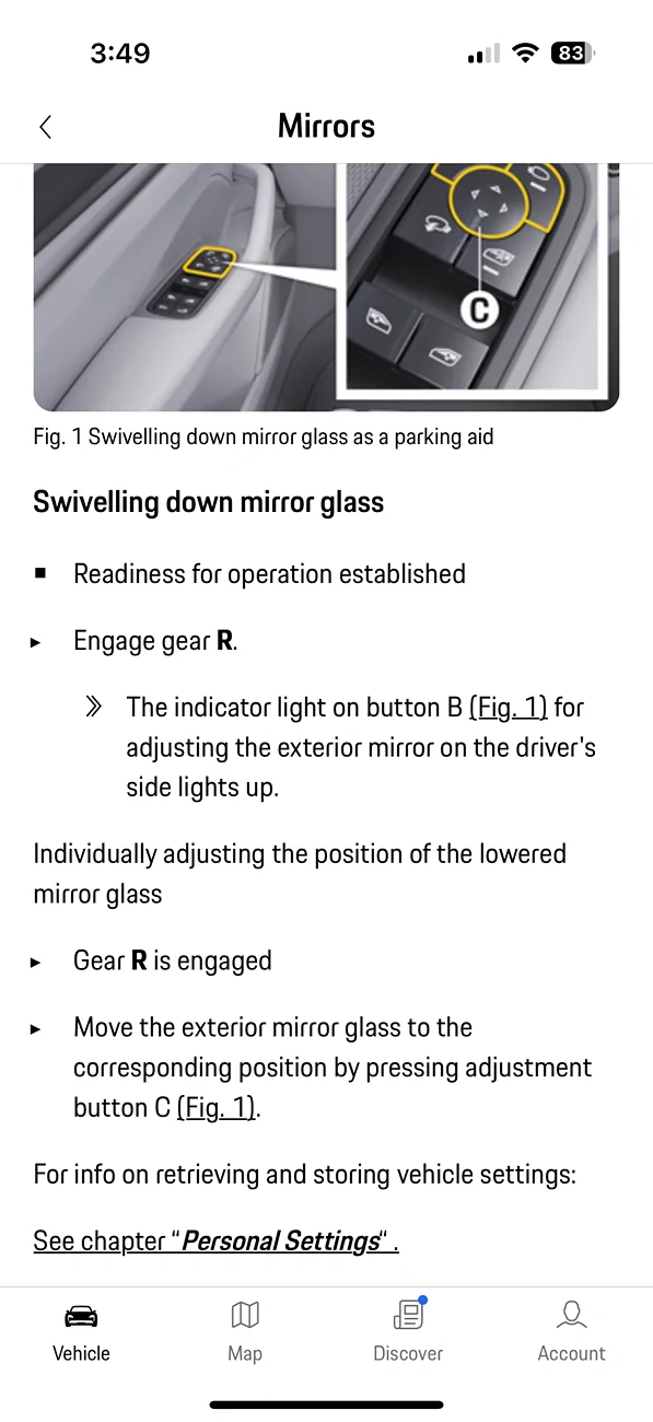

once again:
How to Tilt the mirror glass downwards
  • Ready for operation
Select driving mode R.
The indicator light for button B (Fig. 1) for adjusting the passenger side exterior mirror lights up.
Adjust the position of the lowered mirror glass individually
  • Drive mode R engaged
Move the exterior mirror glass to the desired position by pressing the adjustment button C (Fig. 1).
For information on retrieving and saving vehicle settings:
save to personal settings
320
249

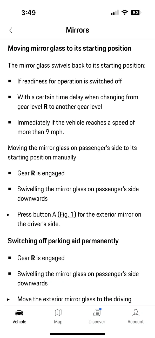

and to switch it off:
Permanently deactivating the parking aid
  • Drive mode set to R
  • Passenger-side mirror glass swiveled down
Press the adjustment button C to adjust the exterior mirror glass to normal position while in "R", save to personal settings.
