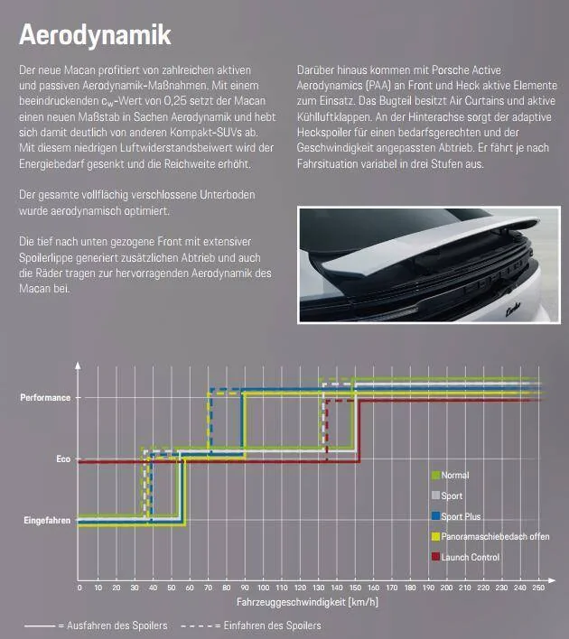

That AI generated graph is terrible. The words are ok though. The German original gives a much better idea of the lines (e.g. Sport Plus in the AI version has 2 different lines for the spoiler going up! Nothing at 150km/h, despite that being important in the original graph)
Here's the original German showing 150km/h for Normal and Sport deployment to the top level.
I've measured Sport Plus at 94km/h, which is a bit higher than the original German graph implies.

I assumed here we were talking about the full extension, as it does indeed deploy half way - 'Eco' - much earlier, as the graph shows.

I can confirm that at 150 km/h in Normal position the spoiler is full extended, in Sport+ and in every driving mode with the roof open (completely) the spoiler is fully extended at 90 km/h
Removed the "IA Translated" graph from my post. The German one is correct.
