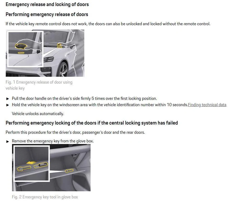

There is an emergency key though located in the glovebox (weird place to store!)?
Also a new feature of holding the key fob to the windshield.
the only purpose of the emergency key is to lock the car, so it’s not so weird!
The only way to emergency unlock the doors is with the keyfob/windshield…
speaking of that, I didn’t try to lock the glovebox, I think we need to use the emergency key, which is weird!
