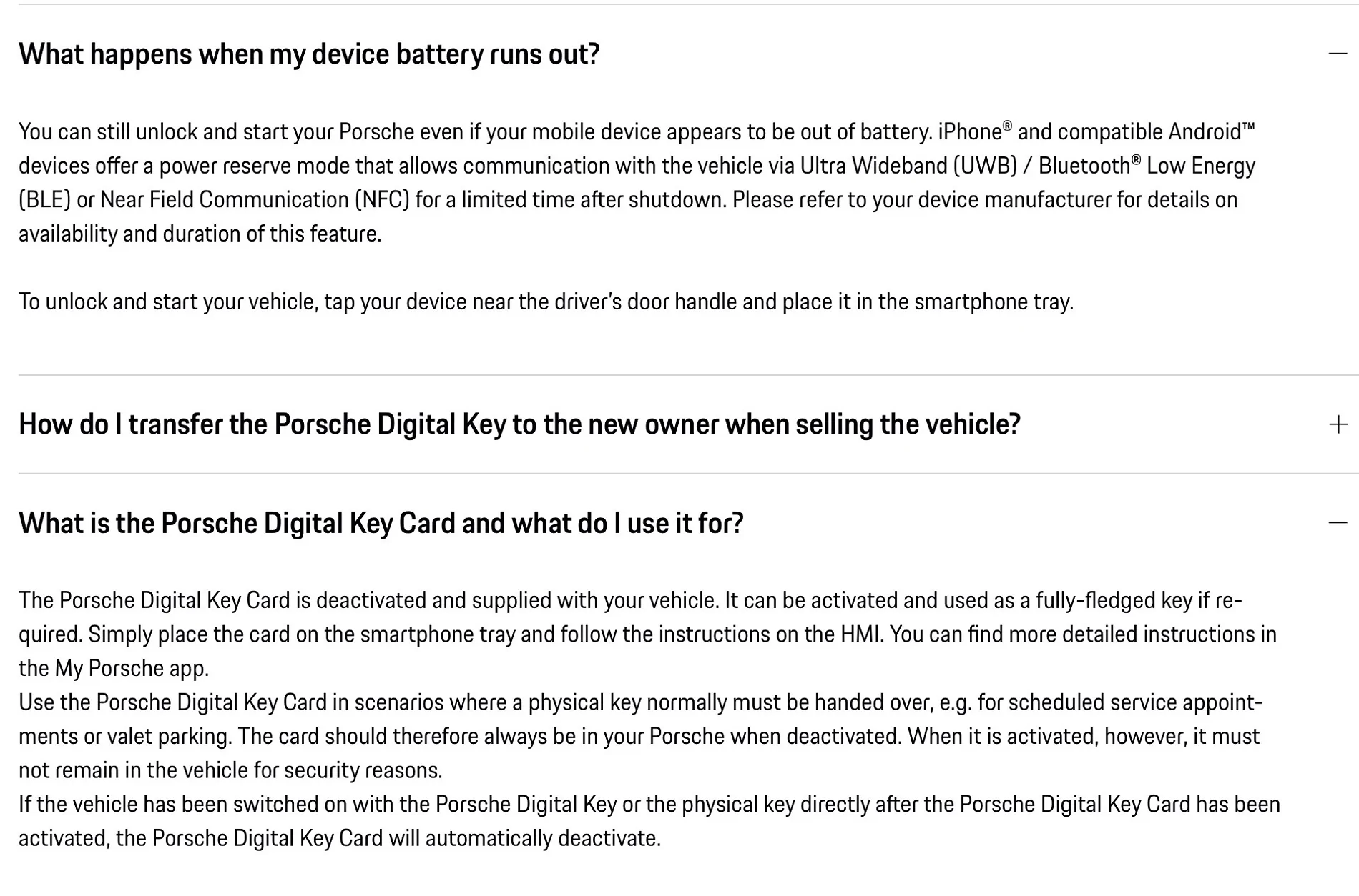

https://ask.porsche.com/us/en-US/digital-key/
@daveo4EV not sure where you get the info from. Tesla is using same technologies nowadays just in a different implementation. (BLE+UWB since 2024 and NFC as backup near the side door pillar).
However, I do not argue that for some the phone will always work and that it's handled like a holy grail. In my area and society it's different.
