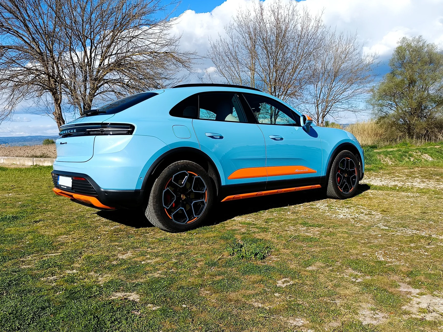

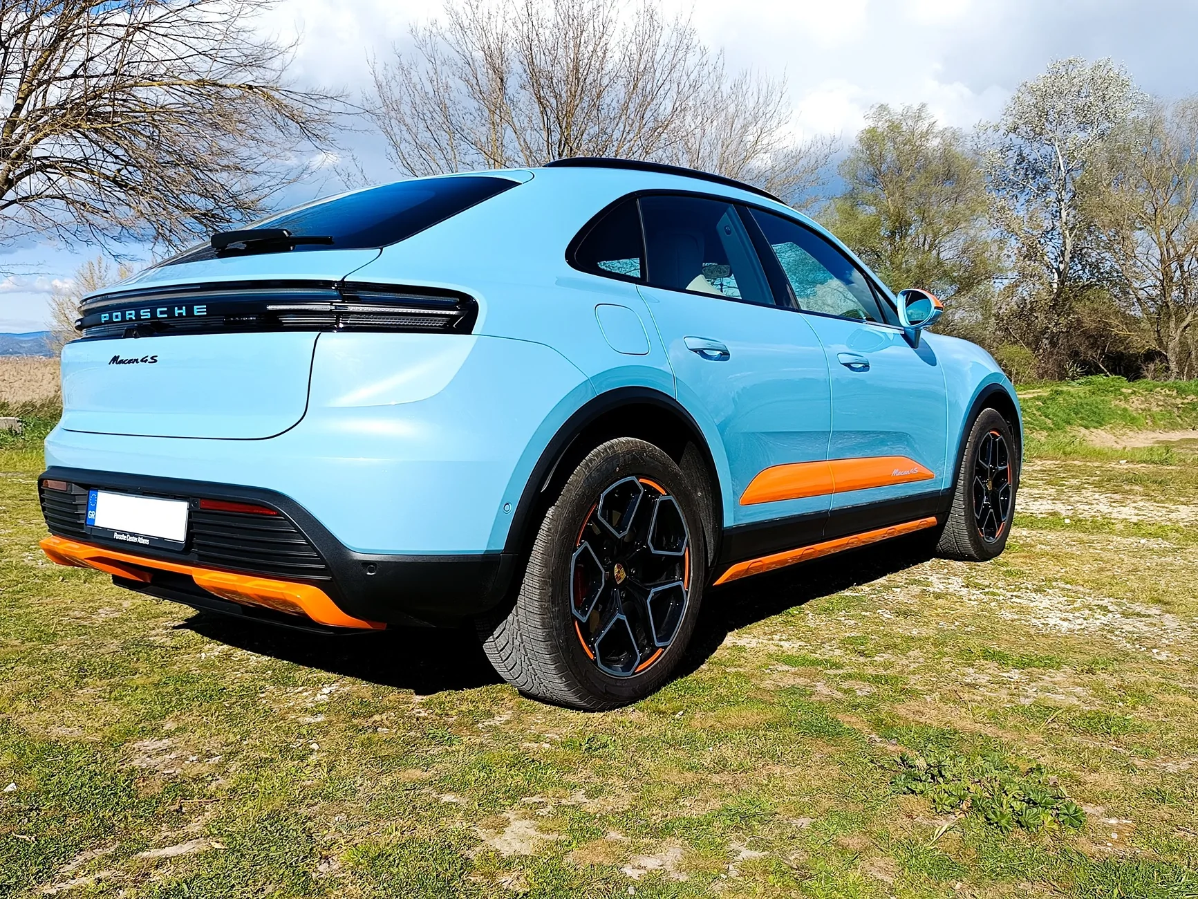

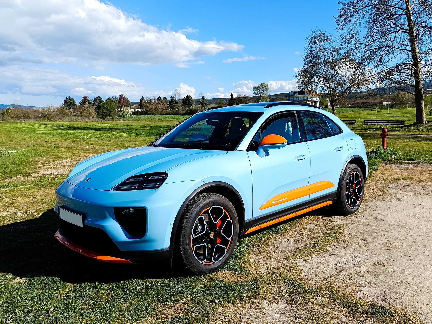

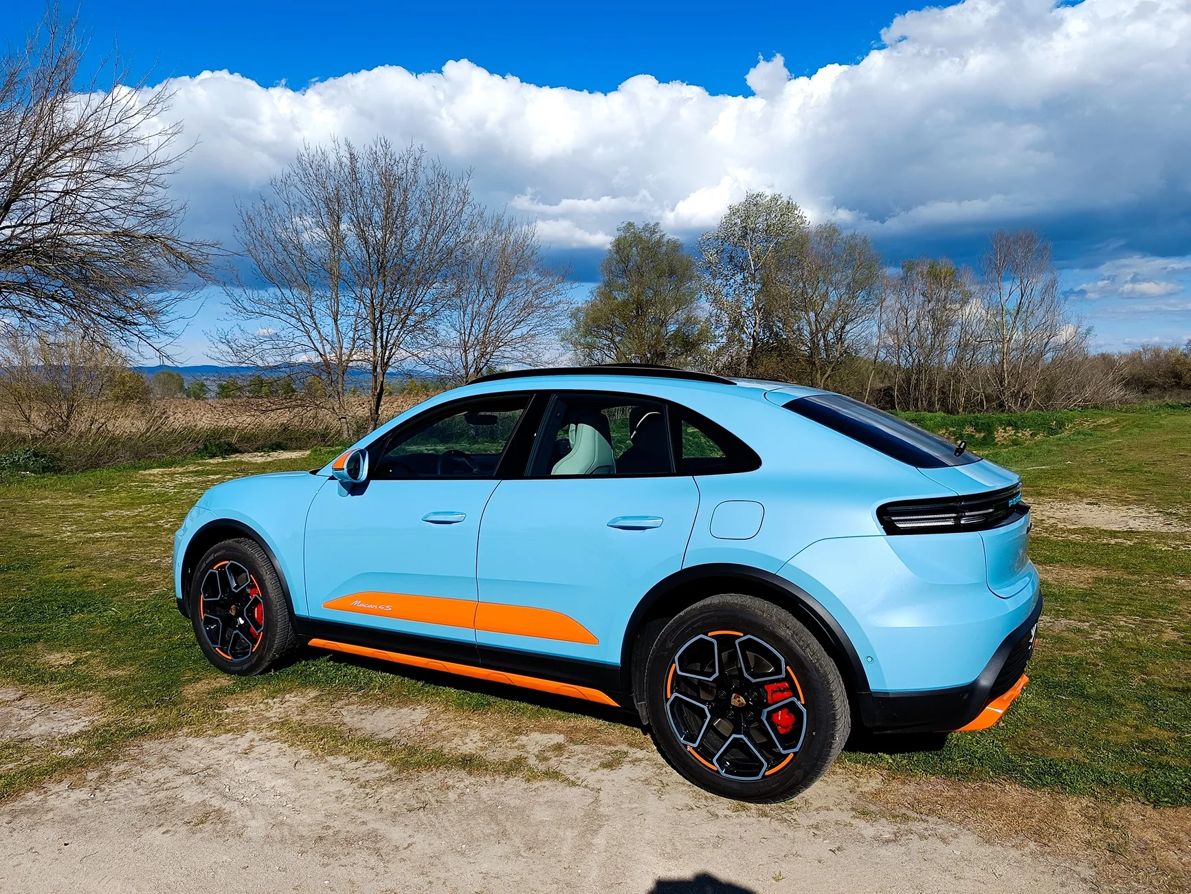

I foil wrapped front spoiler,rear defuser,side skirts and side blades and also the upper mirror covers as well. However, the side blades must be the ones with the smooth finish and also all the other parts be the ones with the smooth finish from off-road option like mine.Most likely the "standard" parts are indeed not possible to be wrapped as they have a quite "grainy" texture including wheels arches unless you got the Turbo version with the smooth surface.

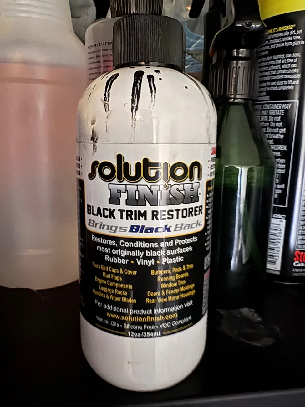

Sadly, you cannot paint textured plastic. It will not hold. I had to order unpainted side blades, and I ended up wrapping them, although those could’ve been painted because they’re smooth. Also, for the same reason, the rest of the textured plastic cannot be painted. the best you can do besides replacing it is to use blackening product to prevent it from graying out. I also learned that except for the wheel arches the parts on the back and front bumper were not even available in unpainted form at least at the time I tried. See a picture of the product I used on it below. It works very well.

Is that a GTS rear apron?
That's a 4S with Off-road package with what appear to be lambo style? custom rims and the orange bits wrapped in well orange.
Missed opportunity not to do orange viper stripes front to back😁
No GTS bits.
