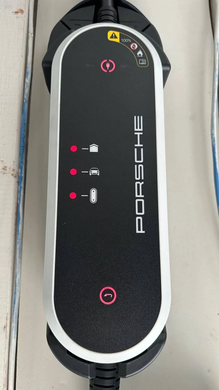

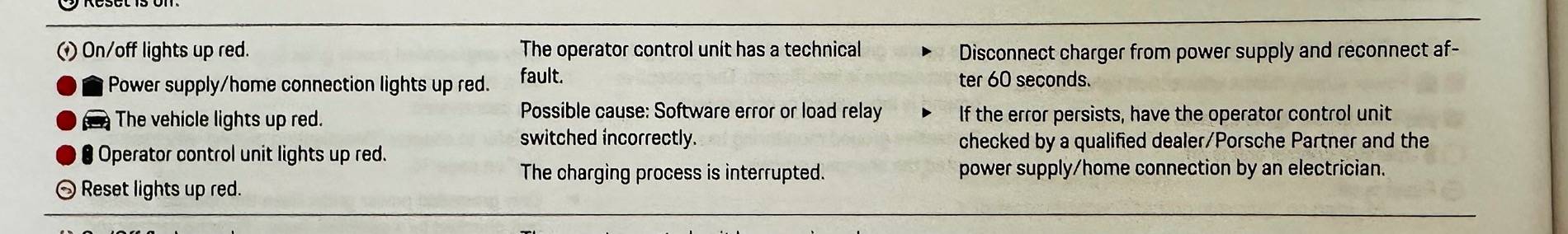

Yea, I now am wondering if it’s defective or they’re all just like this. This morning I woke up and charger lights all lit red, had to unplug for 60 secs to reset it before it would unfreeze. According to the manual, the operator control unit has a technical fault. But my Porsche service centre said there was nothing wrong with the charger or the car. Frankly speaking, I love the way it drives, but the car’s software is buggy. I’ve had issues like the radio’s sound all of a sudden is distorted and it sounds awful. Another issue that happened while I was reversing, the car automatically changed gears back to park, then I put it back on reverse and as I start to back up, it changed gear to park again. It did it several times, and I turned the car off and started it back up. I think that fixed it. Sometimes even though I press the P to put it on park, it doesn’t register and I have to press it again. Now I have to be careful not to let go of the brakes until I see that red P lit. Then there is the car play connecting and suddenly it disconnects and reconnects. Sometimes it doesn’t reconnect and I have to shut the car off and restart it before it would connect again. Trying to connect through device manager doesn’t always work.
Now the electrician that came to swap the socket is charging labour again of $230 and another $116 for the material. I feel like I’m getting ripped off ?

Check your electrical supply and outlet - earthing might be an issue too - looks like that's what you have in progress and hopefully resolves the issue.
83
1,654
2,651
my money is on Porsche EVSE - the North American versions just continuously has problems - many many many Taycan owners gave up on Porsche EVSE's and moved onto any of many excellent high quality alternatives.
the Porsche unit offers no advantages and many downsides…cut your loses and move on.
