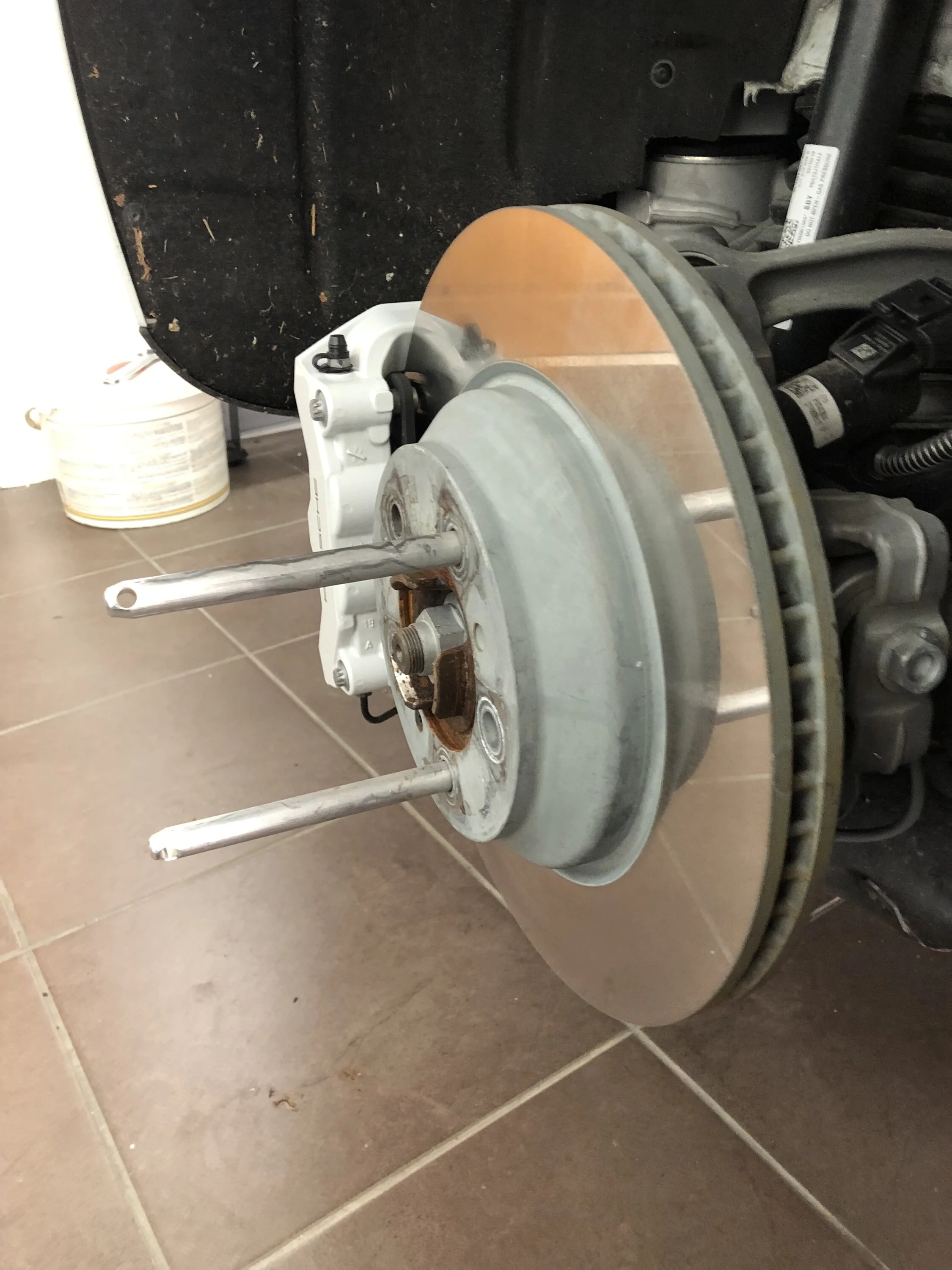

And I don't think a Porsche Centre would supply and fit a non-marked tyre!
Am I being stupidly paranoid about my ceramic discs?
No Porsche shops will only supply and fit NF0 tyres I believe. My service guy certainly said so.
You are correct that the Ceramic discs are very sensitive to any knocks and that could result in an expensive repair bill. So I don’t think you are over sensitive at all
I do not have the Ceramic discs and I have also bought two of these bolts that I bring to the tyre shop. There is more a danger that the paint on the rims could be damaged for me. The tyre shops I have used have been good and helpful and used these guide bolts without problems. I have myself used these as well when changing to winter wheels, and two of them mounted at the same wheel guides the wheel out safely!
https://teile.com/en/porsche-parts-...es/wheel-mounting-guide-bolt-spare-ture/20424
+1
Also have a set of these metal guides I actually use myself when taking my wheels on/off - highly recommended - got mine from Suncoast here in US.
