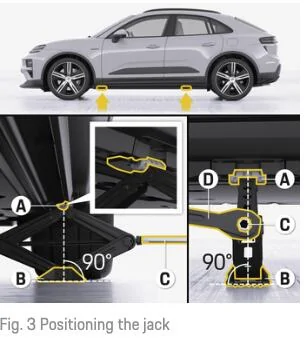

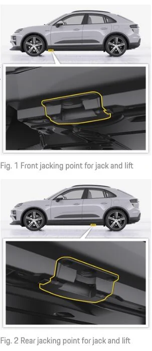

Is that the typical Porshe jack point or will I need to find another adapter for my floor jack?
BTW, these diagrams are in the manual:
Electric Macan EV Macan Turbo EV - home made spare wheel kit? Screen Shot 2025-01-04 at 8.34.33 AM
Electric Macan EV Macan Turbo EV - home made spare wheel kit? Screen Shot 2025-01-04 at 8.34.57 AM

Right…. I finally got it - and you’re right - it’s a rectangular jack head…and no damage to my car by the tyre man.
And under the car there’s some sort of metal sheet protecting everything - the composite material is just around the edges!
Thanks for the pictures!
It is not the same as the Taycan for sure. It looks like the same as our recently totaled Q8 etron. The pad I used on the etron linked below. I will confirm it when we get the Macan in the next week or so.

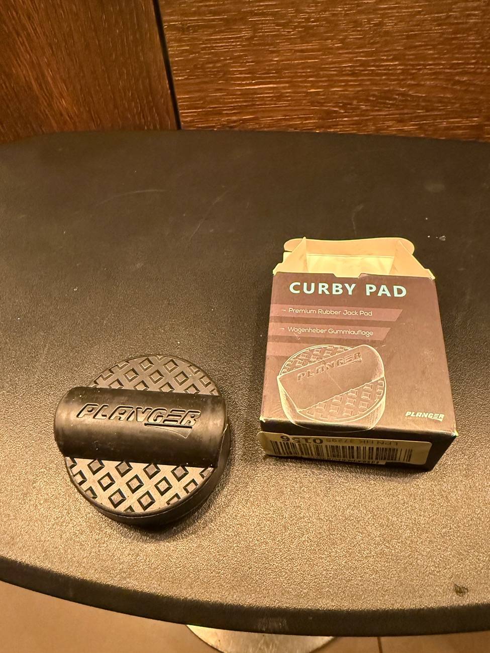

I ordered this puck from eBay. If this fits I’ll be ordering a jack :)
Electric Macan EV Macan Turbo EV - home made spare wheel kit? IMG_1388

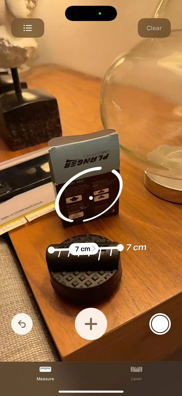

This arrived today and it’s too short and does not fit the car. So tomorrow I will measure the right diameter needed but I’m guessing it’s about 10cms and needs to protrude taller too.
Electric Macan EV Macan Turbo EV - home made spare wheel kit? IMG_0536
Electric Macan EV Macan Turbo EV - home made spare wheel kit? IMG_0535
