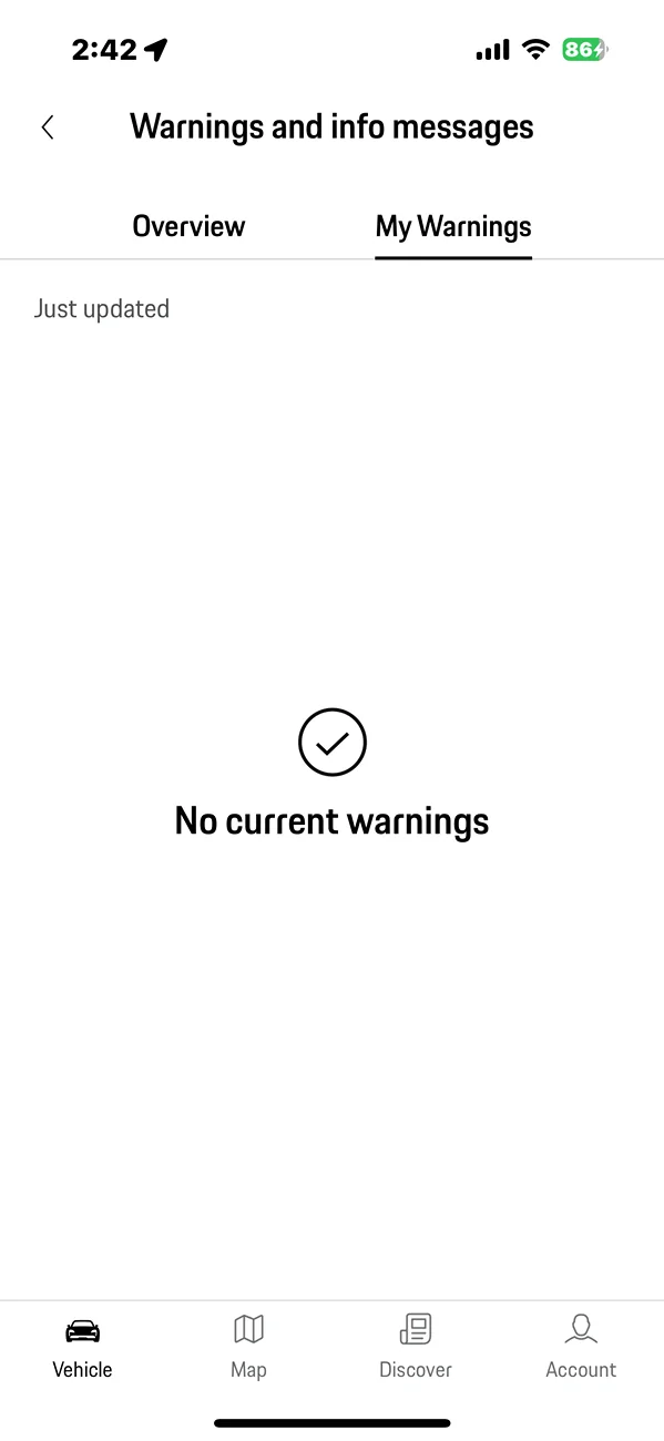

The car should record diagnostic trouble codes and keep them for a while even if there are no messages displayed.
Incidentally, the My Porsche app has a screen that supposedly shows your car’s messages under Owners Manual -> Vehicle -> Warnings and info messages, but I have never seen anything there for my car. Might be worth checking though.

Didn't know about that My Warnings location - mine is sadly empty.
