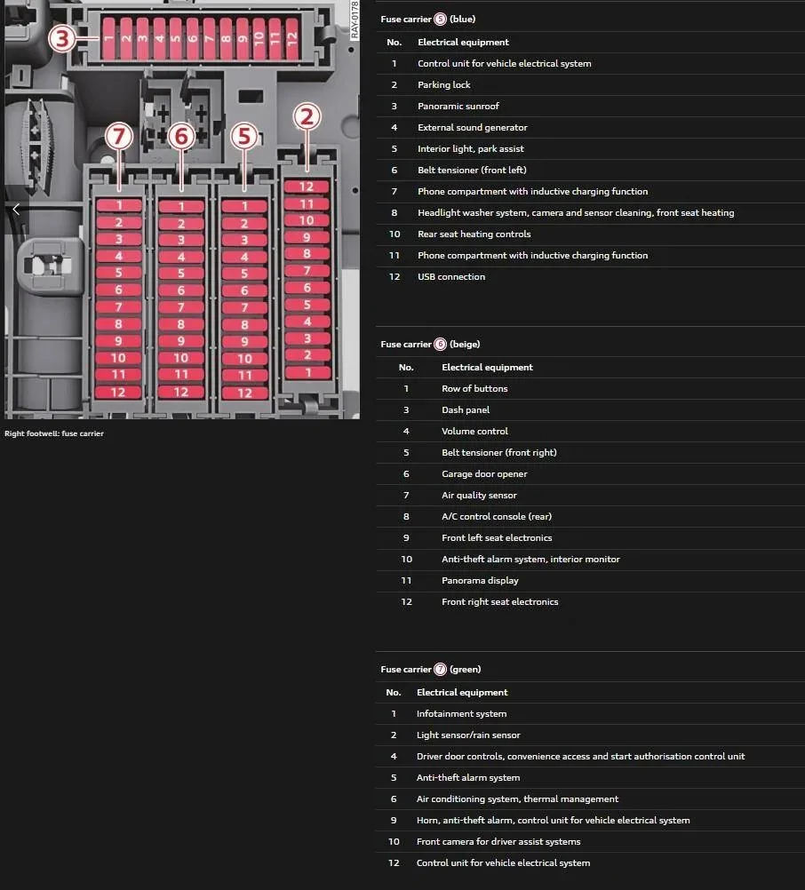

Check the US manual but for UK - https://manual.porsche.com/#/wpi/XA..._GB/topic/id/07b4553499216ec48d24c0b355cf58d1
And I think these are the fuse assignments. Search forum for Dashcam installation for more guidance on fuses and don't rely on this image in case it is incorrect.

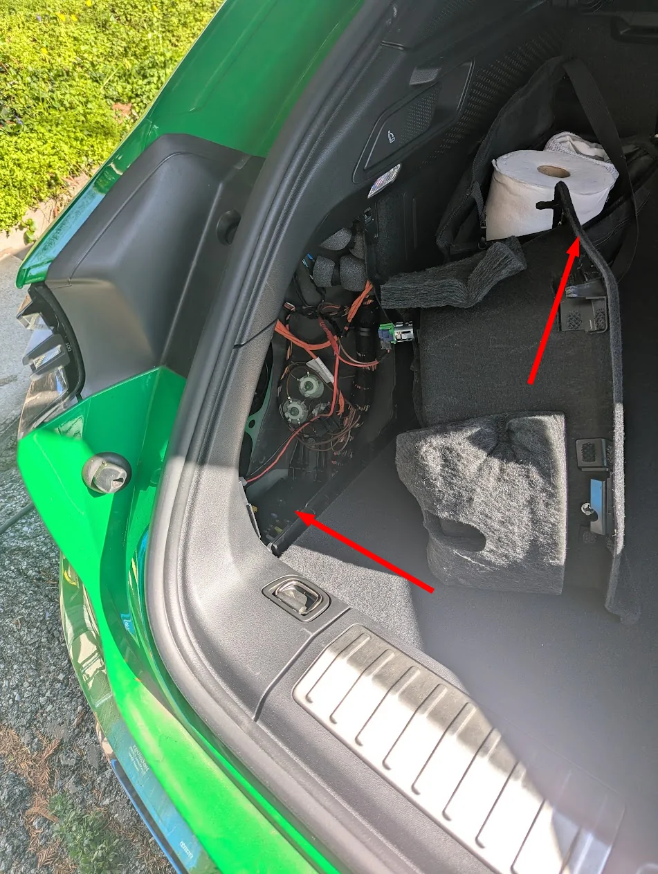

jwatte
Jon
Jun 28, 2025
318
222
US, CA
Electric Macan EV How to activate the 220v trunk socket? 1769279091836-gq
Pull on the top of the left-rear wall insert, it will come out. (First arrow) (It may come out easier if you first open the floor lid) Don't pull TOO far because the cigarette outlet has a wire attached to it.
The fuse box that contains the 120V/240V outlet is in the lower-left. (Second arrow)
