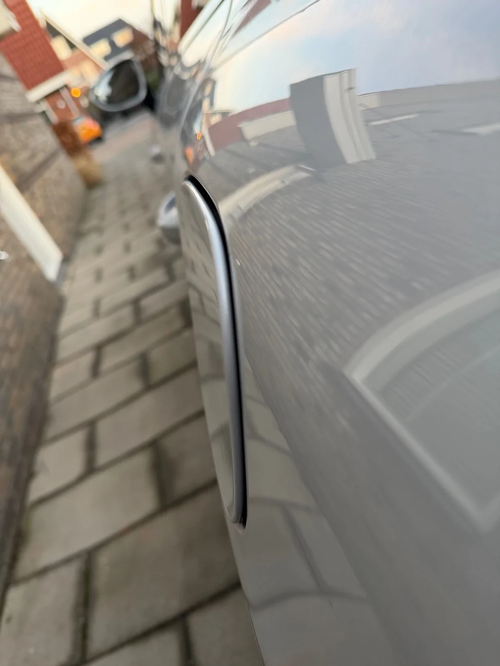

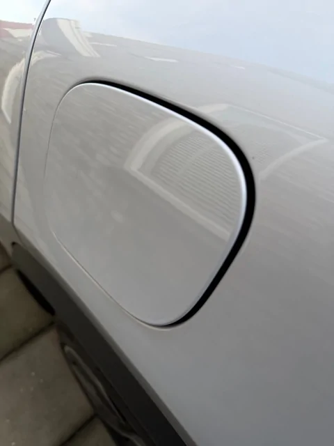

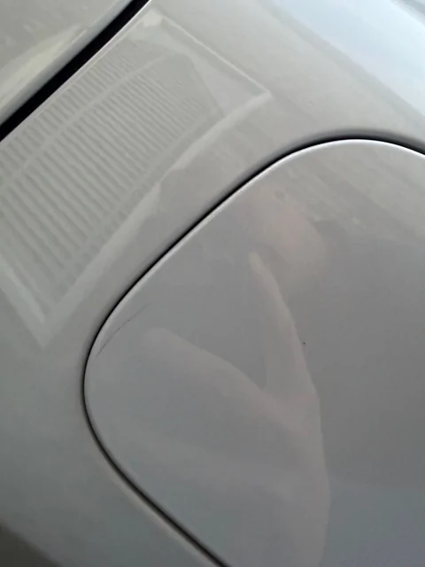

Had the same problem (manual ports) on the right side. Mechanic and trim part were replaced by a updated / revision parts. They told me that the old trim part had some water issues underneath the ā€˜skin’.
Since this week I have the same problem on the left side (port won’t open). The car is going to the garage next week and the mechanic and trim part will also be replaced by an updated version.
I’ve attached some pictures from the current situation!
