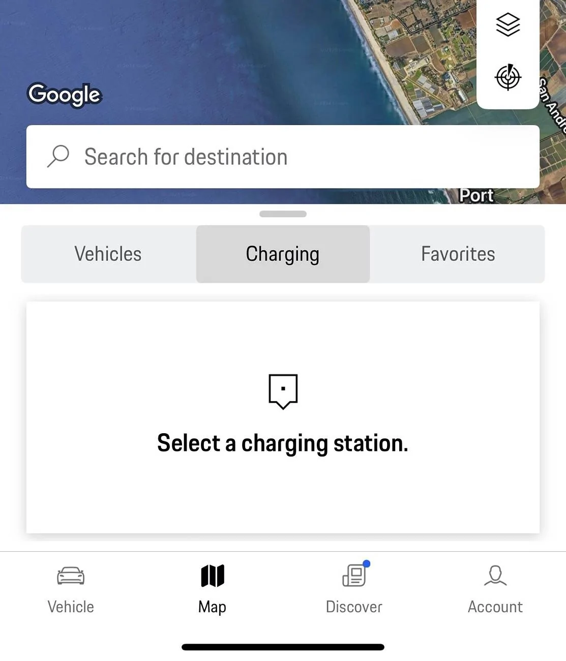

see pic below
map icon (2nd from the left at the bottom of the app)
charging - middle button
select teh charger your at and start tapping on the charger and eventually the stall you're plugging into
best solution however is get plug&charge working and you only need to use the app if plug&charge doesn't work.
starting the charging session via the porsche app is how you get the "included/free" charging.

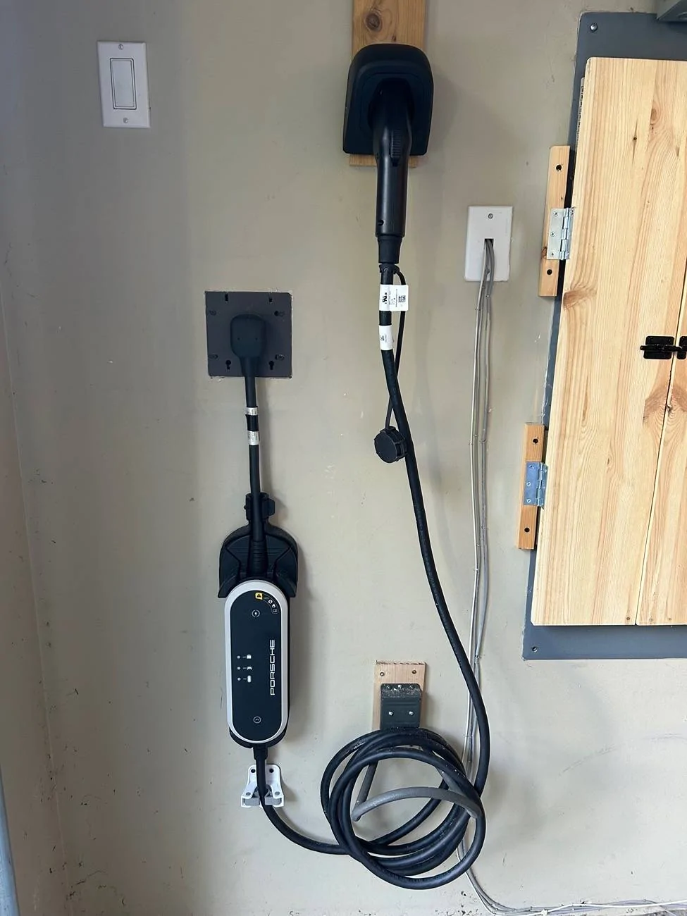

Hi so here is how I set up my garage charger. I just had an electrician install a 220v dryer plug and I always use the charger that came with the car ( I did not buy a wall box or additional charger). He charged me $250 and that was it. Easy and inexpensive.
50 amp or 30 amp and what power supply cable are you using on your PUC?
424
357
50 amp and I used the 1450 plug that came with the charger so your electrician will install the correct dryer outlet (I.e a 1450 outlet) and did not need any other cables.
perfect - Hubble NEMA 14-50 outlet?
424
357
Yes indeed. I just showed the electrician the 14-50 plug and off he went. I actually have two of these in my garage …long story but I have two EVs but I only charge one at a time although I suppose I could as they are on separate circuits.
