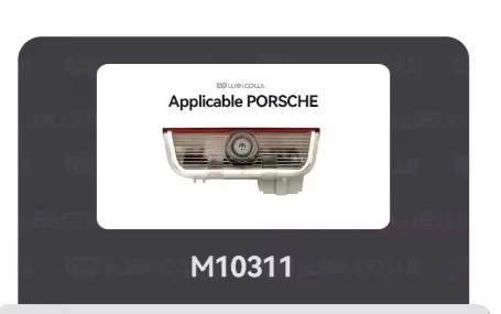

@Awaz: you ordered the M10311 and it has the connector on the side. The M10316 has it in the middle.
So today I removed the light from my door and the connector is also in the middle. So should I order the M10316 or will both versions fit?

Frankie, you are quite right.
I noticed that too. It did cross my mind whether I got the wrong one, but the connector quite easily fitted into M10311 as well.
I think clarify this by sending a message to the seller, which one would be better and what's the difference between the two.

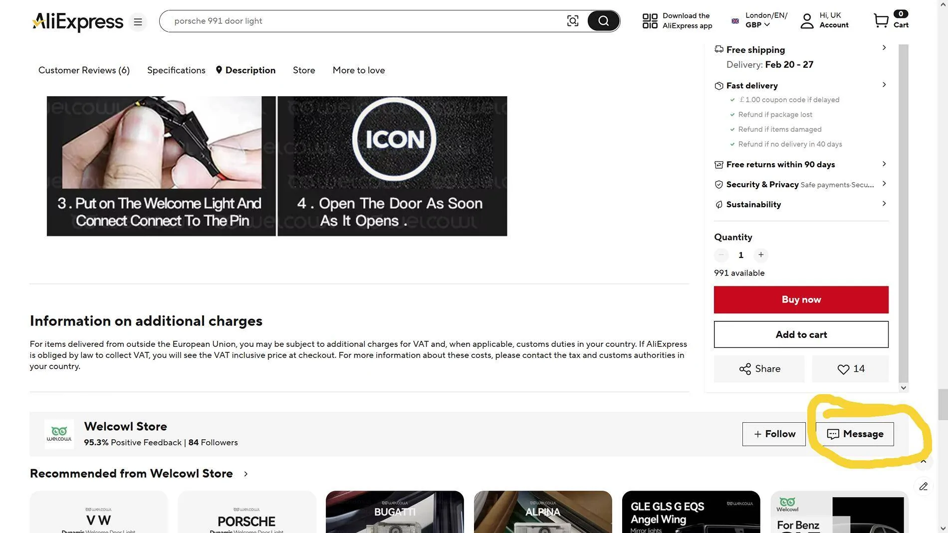

If you scroll down on the seller's listing, there is sending message option. See circled in yellow. They do respond, may be after a delay as different time zones.

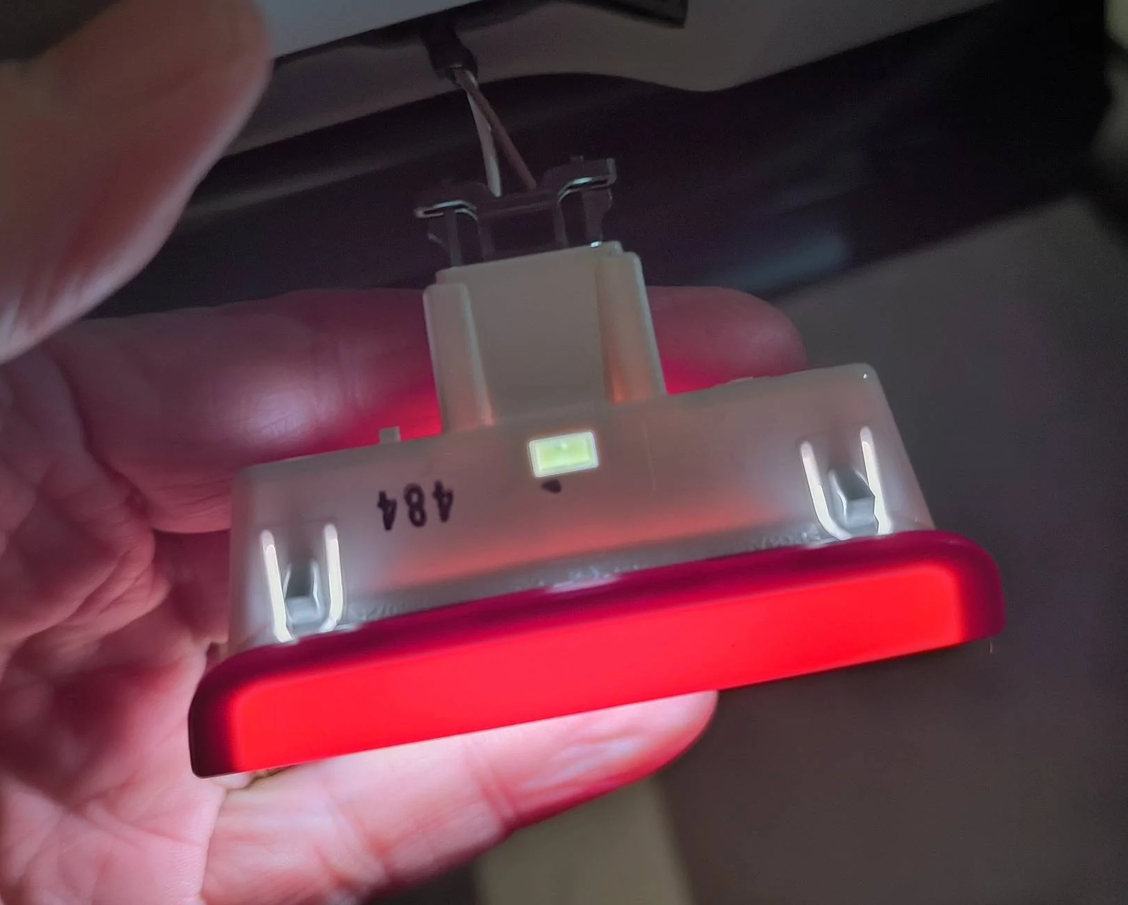

Had me worried for a second as I had ordered the M10316 version as well to see everyone posting that is was the M10311. When I had looked at images for the original part number, the M10316 looked the most similar so I had ordered that.
Having said that, I suspect the only difference as others have pointed out is simply the location of the connector (centre vs side) and it seems that the cable seems long enough either way.
@Frankie / Others - Could ask you how difficult the removal process was? Were the clips at the side edge (ie side facing into the vehicle)? That’s the only part I concerned about in terms of removal of the existing lights.
Will be trying my hand at the installation next week when I finally take delivery - car is currently being PPF’d at showroom.
Photo below of mine for reference:

it's not hard at all. If you have a plastic pry tool... insert an pry at the corners of the light, as you can see in you pic, the clips are at the edges. Its only pressure clipped in from the front...the back side is hooked.
so once you pry out the front, it just falls out.
putting them in is the same, hook the back in the space, and press the front in
as for these different models...maybe it matters for other cars, but there enough space in the bottom of the macan door that the socket being in the middle or the side doesn't matter.
if the connector is the same, it'll work i think. That being said, we have confirmed the 311 version works

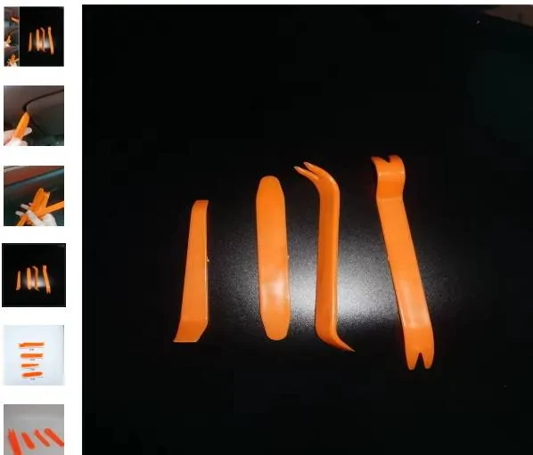

Removing the existing lights is very easy. I use the tool in the photo for this. Insert it from above in the corners and then simply remove the light from the door. Then manually click it back in. It is really easy.

The puddle light I ordered came with a little screwdriver as well.
But I used a plastic pry tool I already had that came with Blackvue camera. It looks like the first one on the left, in the above picture.
