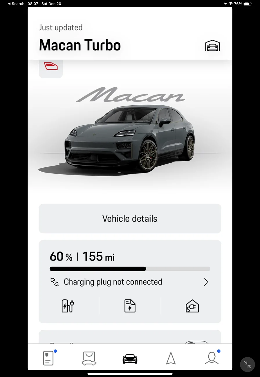

i am really sorry to disappoint again. but my turbo is parked right now in my garage in Vianna. I left for miami two weeks ago. i parked with 60%. today it has 60%. it is not attached to an charger.

As I said:
(The app is useless for verifying this data because it doesn't update the information until the doors are unlocked. You have to open the car and check the SoC.)
I'm not saying that a 1% daily loss is normal, at least not without supporting data. But I can say that a 0% loss is not normal; in fact, it's impossible. Keep in mind that even a disconnected battery loses charge over time.

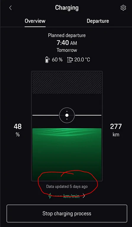

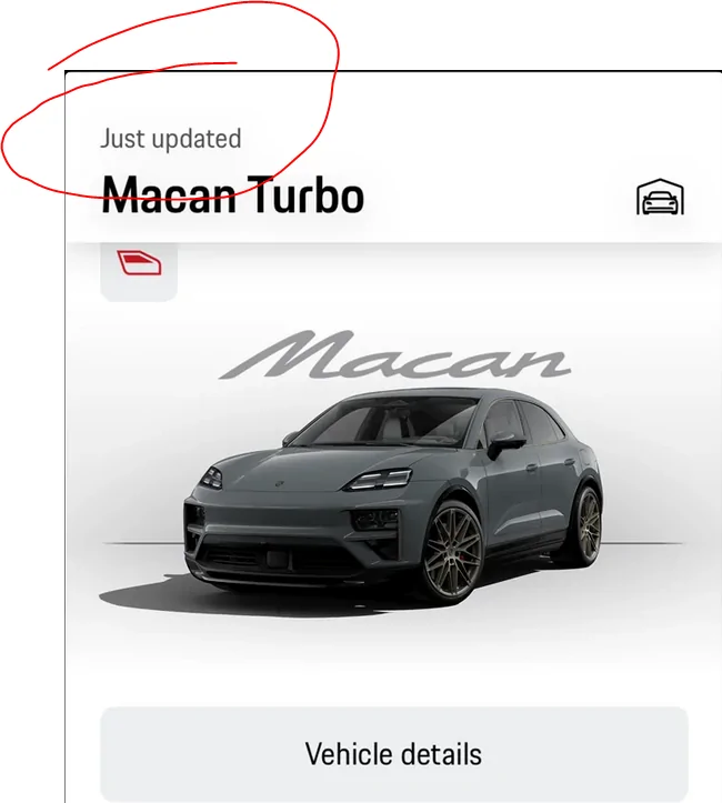

Sorry @Petzi, but you shouldn't look here.
Electric Macan EV Turbo - red circle of death, perhaps a fix for my car... but battery idle issue 1766240052102-8i
You should look here.
Electric Macan EV Turbo - red circle of death, perhaps a fix for my car... but battery idle issue 1766240016982-vg
Anyway, forget the app. To check the SoC status, you have to unlock the car, sit down, and start it.
One thing's for sure: the car consumes energy while stationary (all cars do it, even ICE cars). How much energy? I don't know; I'd like more information to find out.

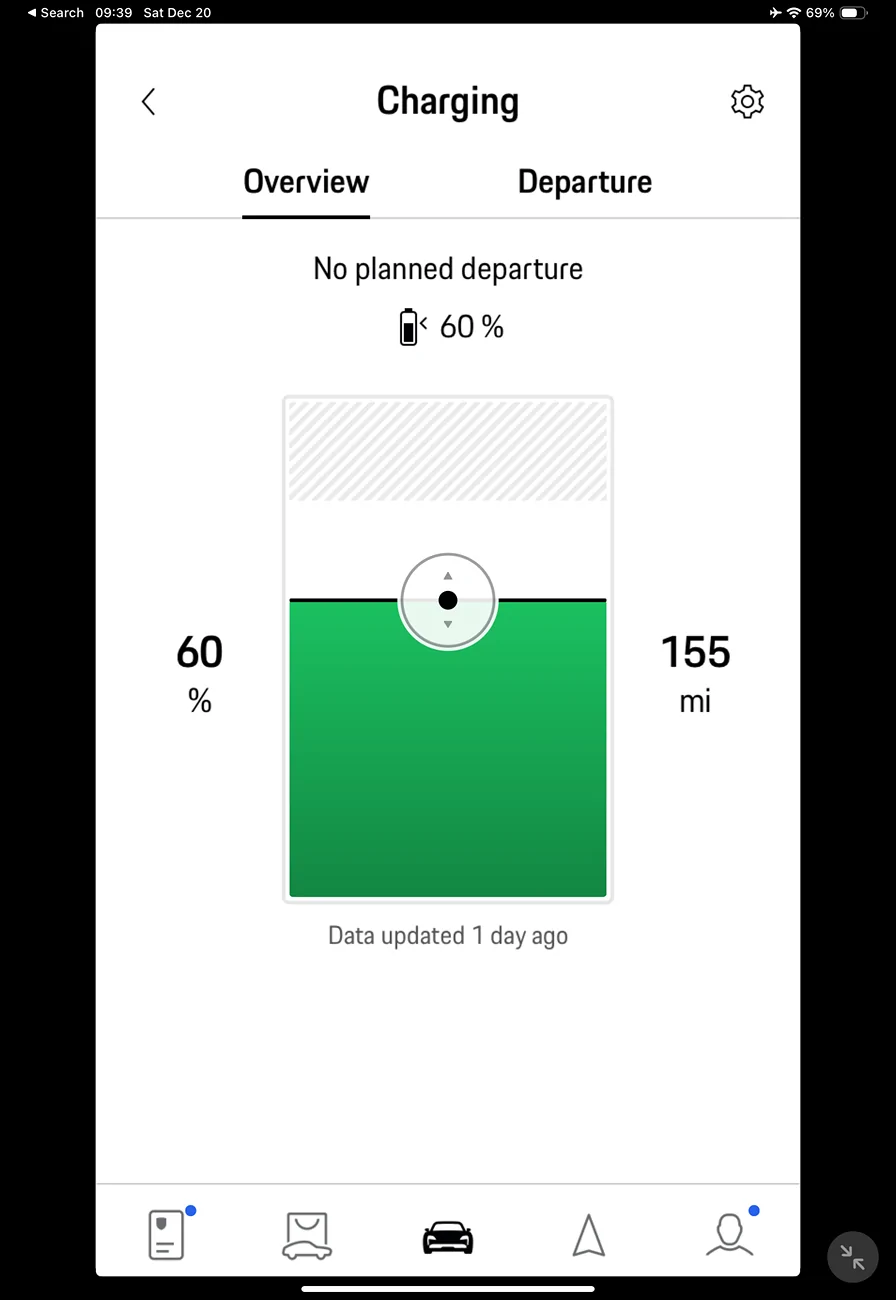

@TurboSpain sorry again. but you are wrong. 1.) this has nothing to do with SoH. 2.) my data has been updated „one day ago“. nobody opened any door or started the car. the car is switched off of course. and yes it needs some energy which it gets from the 12v battery „like any other car“. (like any other car including ice, the 12v battery can do this for weeks. should it get drained below a certain level, the high voltage battery will recharge it.

All of three cases show different update dates: 1, 3 and 5 days since last update. Either software it is set up to this at 5+ days intervals or something is triggering this. I have no idea how many modules are measuring high voltage battery capacity and charging state and how they are connected. As @Petzi is as confident about this as Porsche dealer are about software updates fixing all problems I wonder if he could point us to technical details.

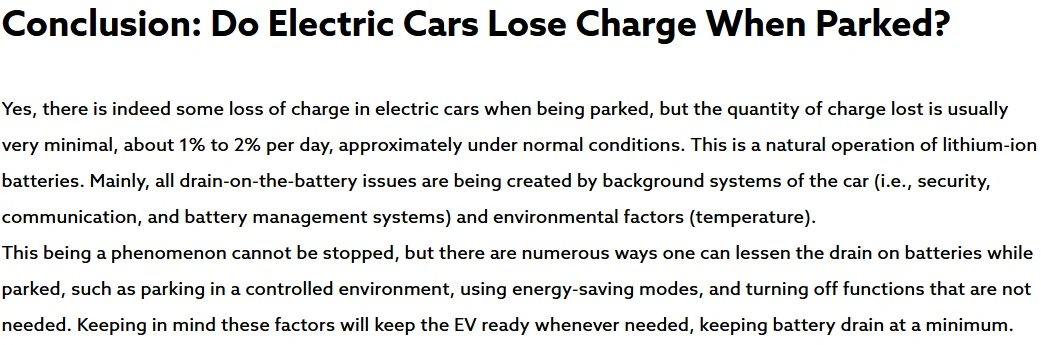

I don't want to start a debate. If someone thinks an EV doesn't lose energy over two weeks, good for them. That's not the case with my car, and I don't think it's the case with most others either. There's a lot of information out there about other EVs, but for Porsche in particular, there isn't much data.
For example, this article summarizes it like this:
https://chargerigs.com/do-electric-cars-lose-charge-when-parked/
Electric Macan EV Turbo - red circle of death, perhaps a fix for my car... but battery idle issue 1766244704147-mv
It doesn't matter if the energy comes from the auxiliary battery or the main battery, since the auxiliary is charged with the main. We also don't know how the Macan calculates the SoC (because it's a calculation based on the cells, not a direct measurement), but what is certain is that there is power consumption.
The Macan user manual says that it should be left connected to a charger if it's going to be parked for a while. There must be a reason for this recommendation.
