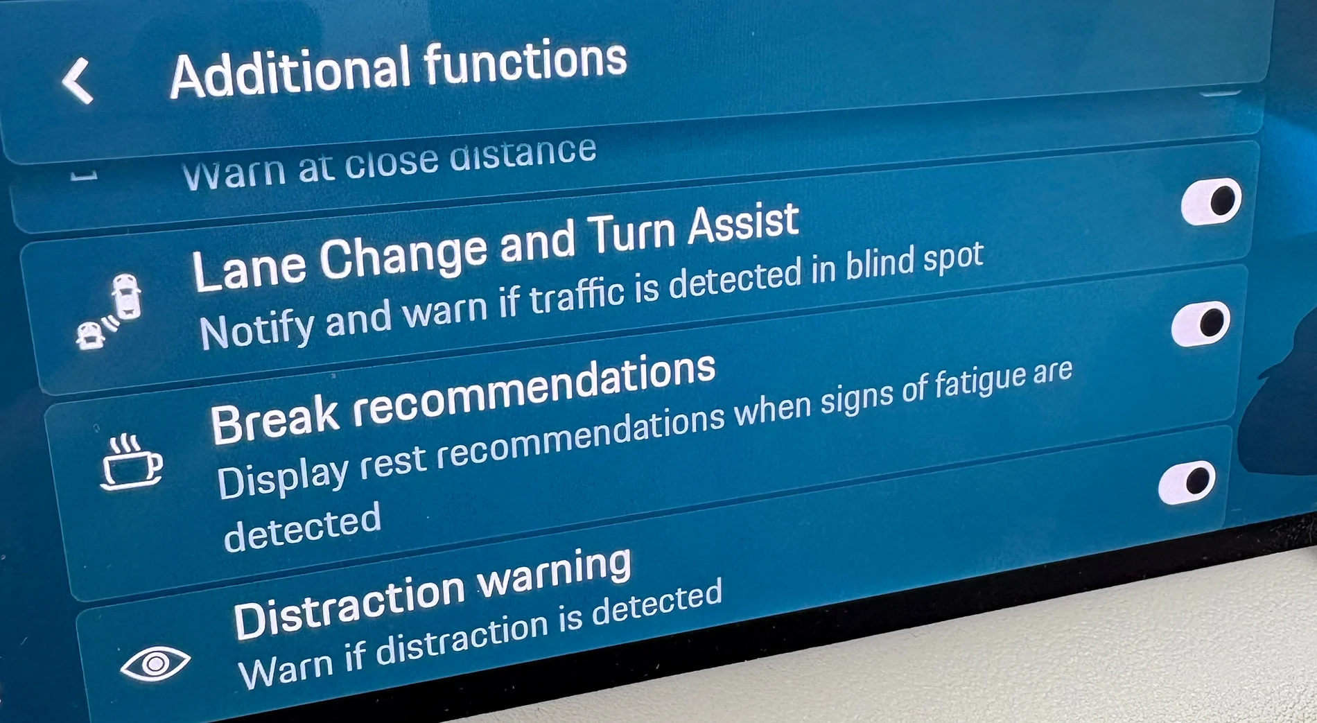

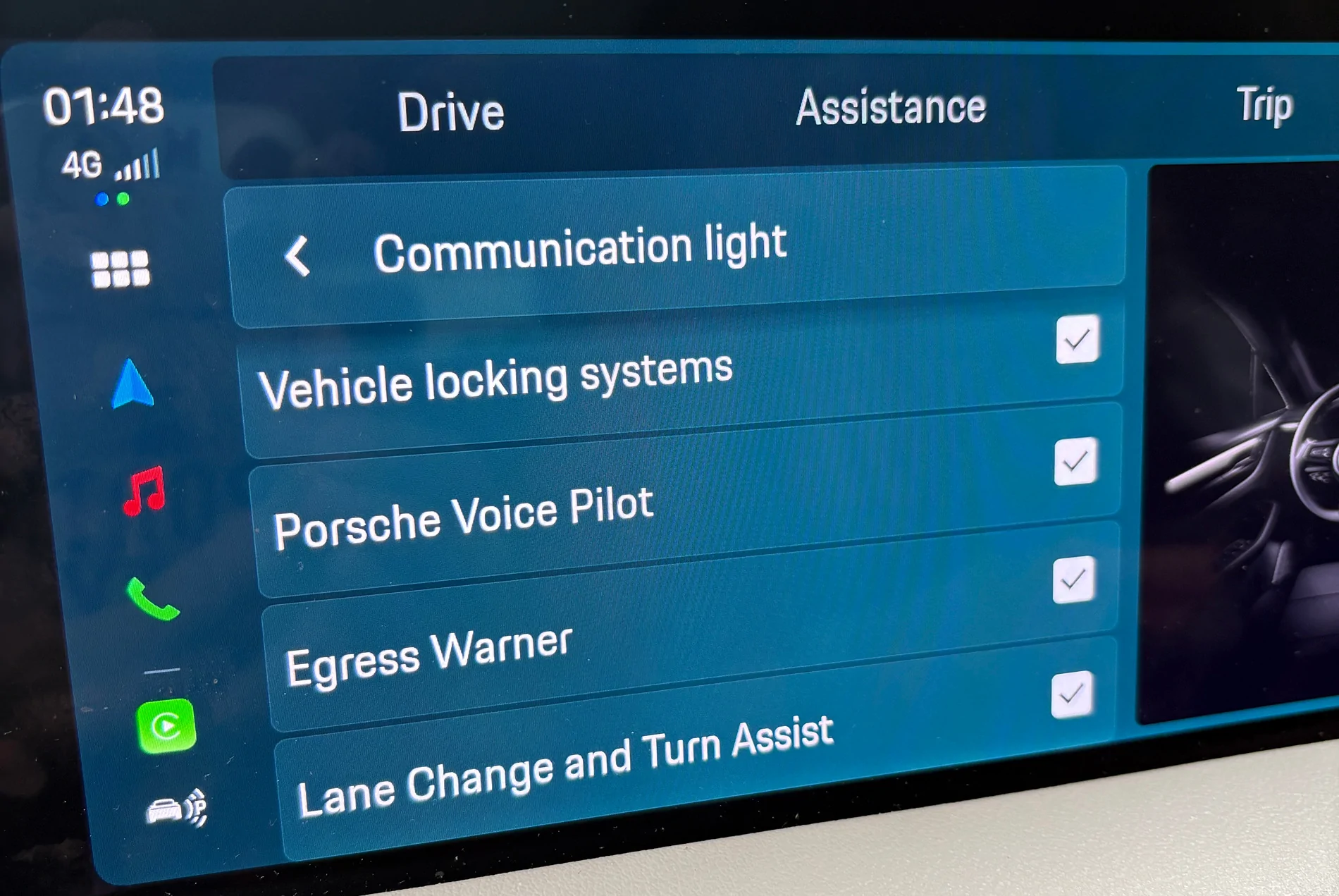

I have a 2026 Macan EV and the warning lights are no longer working when traffic is detected in my blind spot. Either side! I have checked the assistance settings and the Lane Change and Turn Assist option is on. I have checked the Communication Lights setting and the option is checked. I have turned the options off, waited 15 minutes, and turned them back on again. Still no warning lights. The solution that worked for me: reset the mirrors by tucking them in toward the car. At least that worked - this time!
