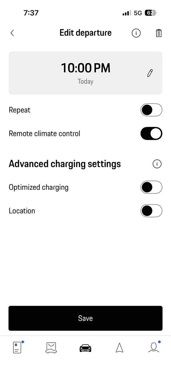

The problem we have had is that we set it up correctly but them we find that the Porsche app has put up a pop up message saying that we want to end the charge time at some random future date. The result is that it also halts the charging. In the morning we find that the EV is only partially charged.

I should have said that we have wrestled with this problem for weeks, trying every combination. It needed the Zappi app and the Ovo app to work at all. The Porsche app alone couldn't do it. Adding the Porsche app messed it up because it wanted to force another charge end time over the one chosen.

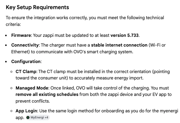

I have the Porsche EVSE and used OVO Charge Anytime - only ever used the Ovo app as Ovo could (then talk directly to the car rather than the EVSE (wall charger)). This has changed in recent months with the introduction of Ovo Charge which can talk to the car (Macan is on the list) or to a specific EVSE (Zappi models are on the list).
Basic premise is that if on a rate saving tariff from Ovo / Octopus then you are essentially obligated to use their app and have a Smart Meter in place - Ovo will 'talk' to Zappi (models 2.1 or Glow) if setup correctly thereby negating the requirement to use multiple apps and remove / reinstall another. See guidance on "Managed Mode" below (Zappi requirement and My Porsche App requirement):
Electric Macan EV Charging problem 1774973266554-r7
Did you remember to onboard your Zappi to Ovo by linking?
