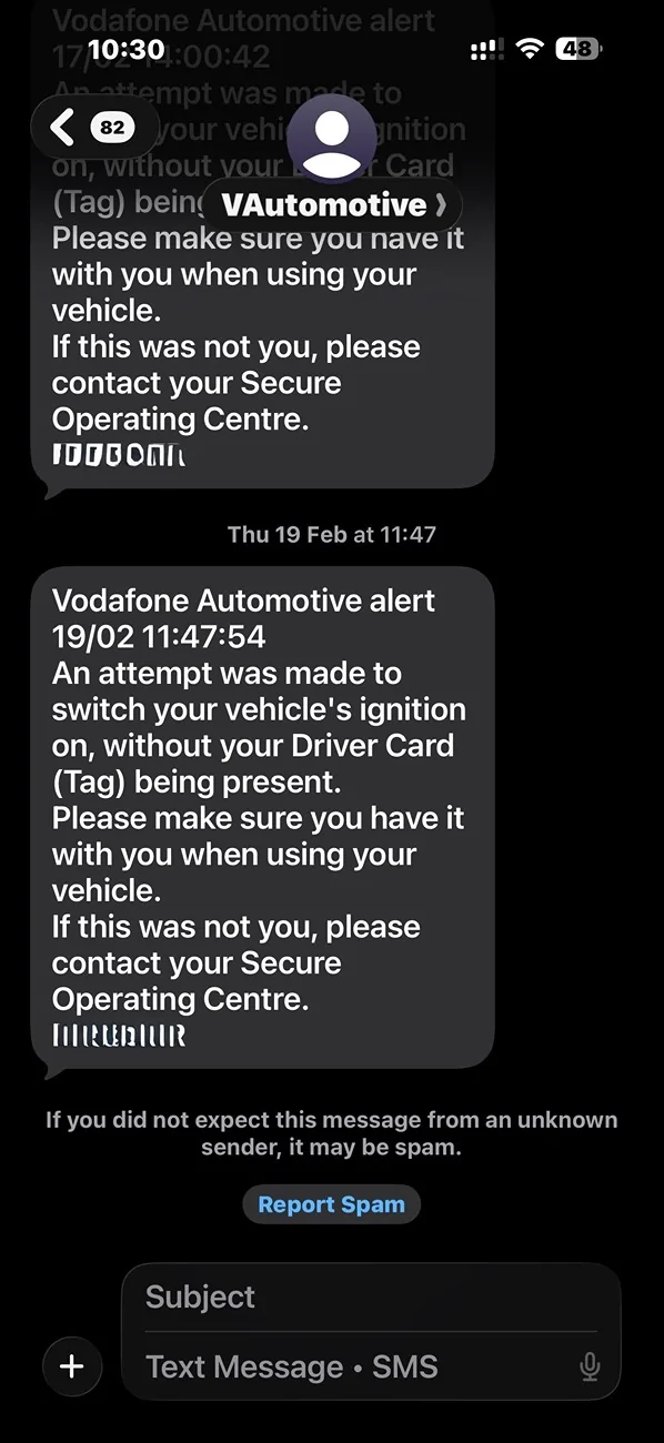

The car will have an immobiliser by default and so anything you do with PVTS is in addition.
The "+" simply means that the 2 drivers cards (fobs) that you got with the car can be activated and paired to the car for the additional feature set.
When activated you must keep the the fob with you when driving or moving the car otherwise a silent alarm will be triggered to Vodafone. Leaving the card in the car deactivates the service.
Silent yes but noticable as the PCM tells you that fob/tag is not present usually followed by a phone call. With it no longer integrated and being a standalone notifications are sent by text. Haven’t had it long enough too see if you have low battery alerts.
