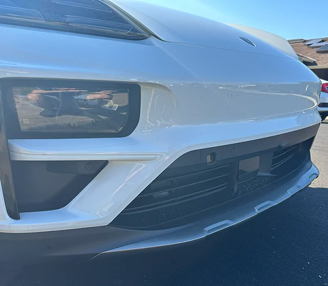

Custom project. Designed for safety / animal collision avoidance at night.
Demo video (software still a work in progress):
Camera location:

Everything runs off an Nvidia Orin Nano sitting in the frunk. Using a YOLO model trained on thermal data.
See blog post here (directionally correct; I’ve made a bunch of changes since that aren’t reflected):
https://www.sahouh.com/build-logs/part-5-inferencing-at-60-fps
For those interested in the hardware side see here:
https://www.sahouh.com/build-logs/hardware-integration
