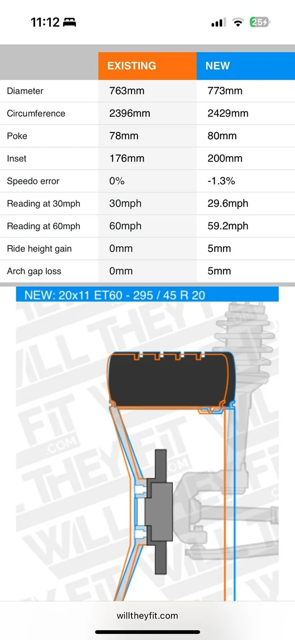

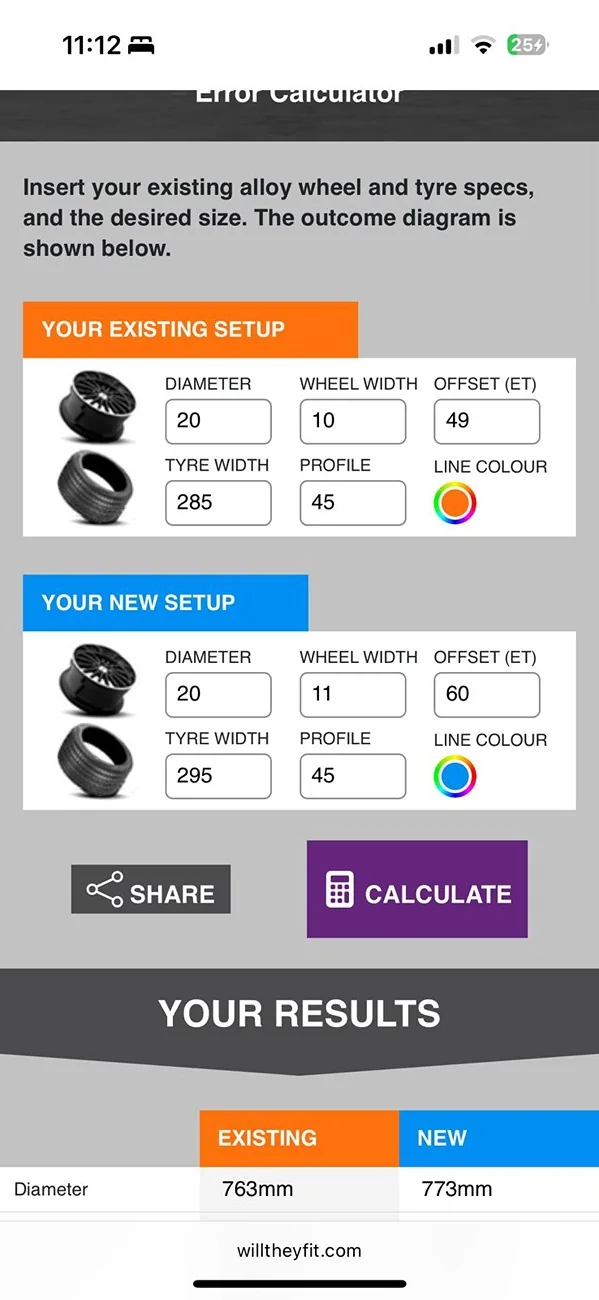

Hello Soundman,
I also have a Macan 4 and want other 20" rims. with he Taycan wheels there is a lot more to choose from.
Any issue with your setup so far, what tires are you running??
Macan XA EV : Front: 7.5Jx20 ET 32 Rear: 10Jx20 ET 49
Taycan : Front: 9Jx20 ET 54 Rear: 11Jx20 ET 60
It looks like they should fit. I only compared the rear wheels but need to go with 295 width instead of 285 as the rim is 11.00 in width?
Best Regards/ Viele Gruesse
Martin
