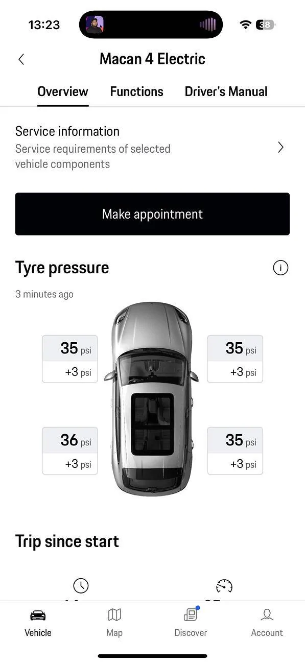

Here mine - was wondering should I reduce the air !

doesn't that show that your pressure is actually low normally?
isn't the +3 the deviation from normal or when it was last set?
It means 3 psi higher than normal (or optimum).
Ours has displayed -1 for a month of cold weather but rises above normal fairly quickly during highway speeds. I leave it low in case of snow.
