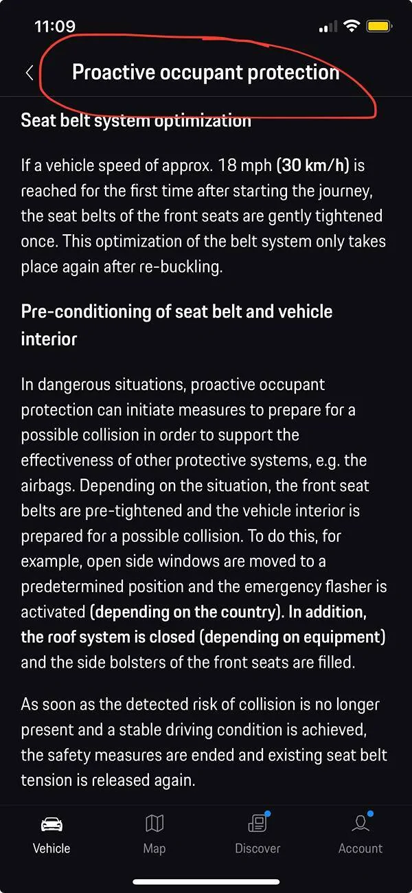

are you referring to the proactive occupant protection feature?
Electric Macan EV Seatbelt pretension hug 1742148654028-lk

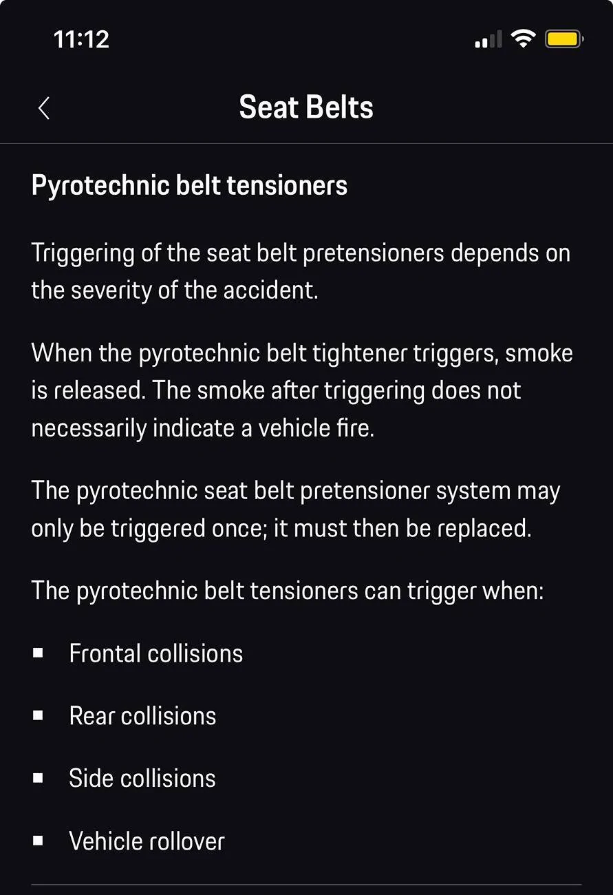

also, on the topic of seatbelts… why does it release smoke in the event of an accident??
is that to alert passersby to call 911 in the event that the driver is incapacitated? Good thing I stumbled across this while looking up the seatbelt tightening feature lol, otherwise I’d probably freak out if I started seeing smoke after an accident lol.
Electric Macan EV Seatbelt pretension hug 1742148809483-ax

The pyrotechnic seat belt tensioner is similar to an airbag inflator. both release smoke when they fire. The difference is that most of the smoke is contained in the airbag (at least temporarily). There are vent holes in the airbag so the smoke will seep out.
ahh I see so it’s a side effect of quick deploy, not necessarily a built in feature

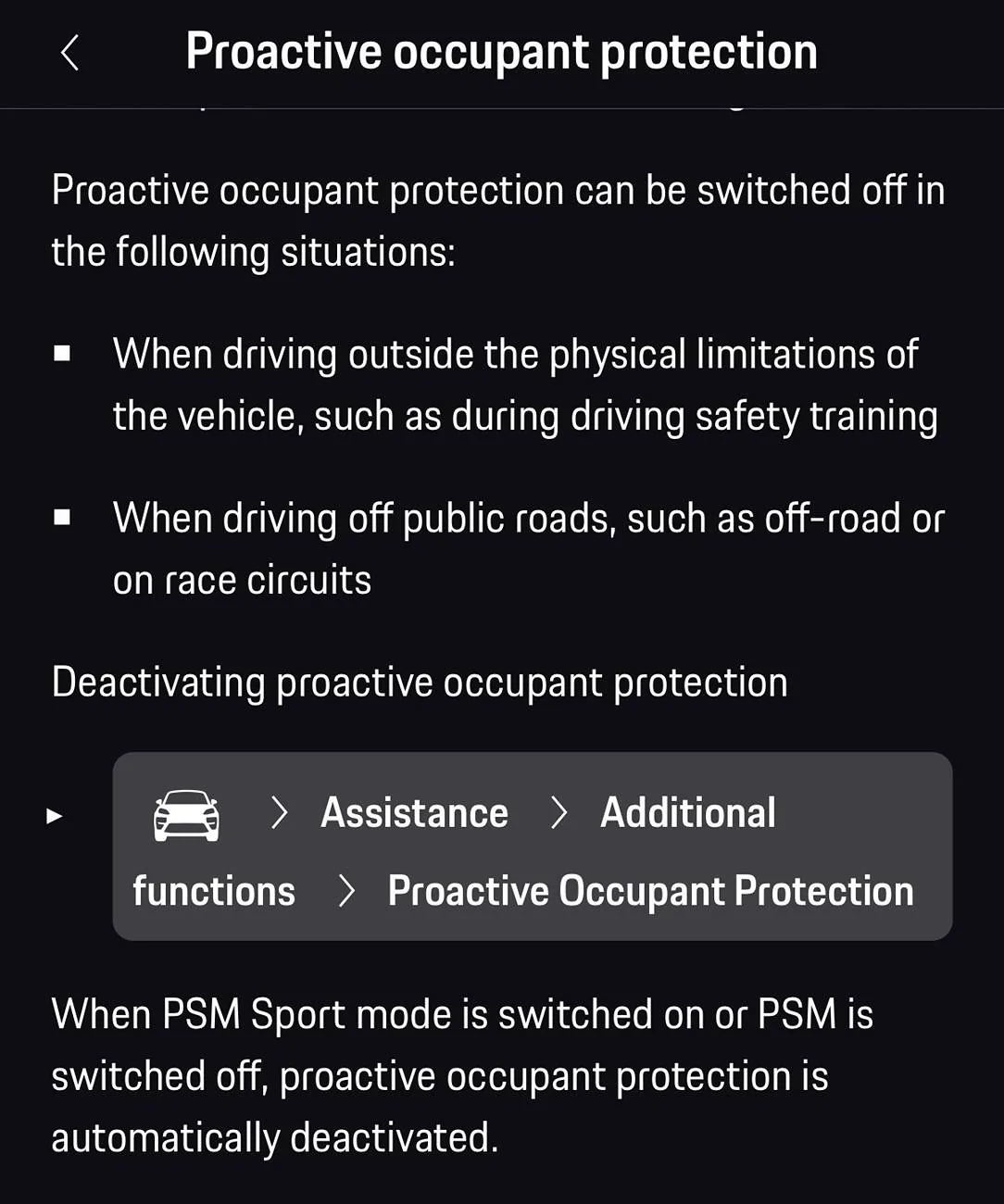

If you haven’t found already - Would assume activating on the seatbelt ‘hug’ (part of Proactive Occupant Protection) is the opposite of turning it off.
From further down the manual that @cottony screenshot:
Electric Macan EV Seatbelt pretension hug IMG_4754
