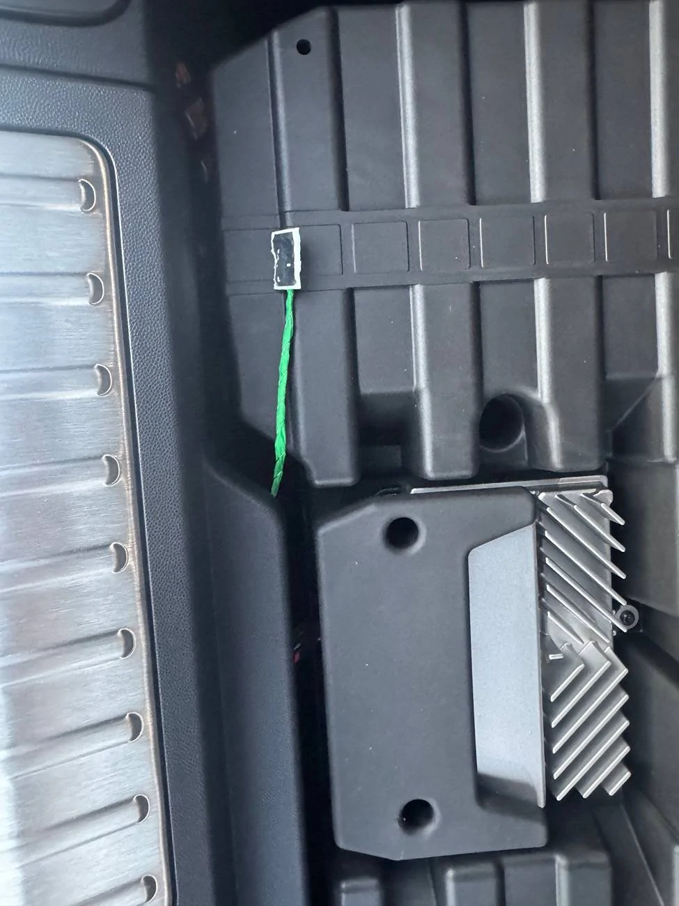

Electric Macan EV SAT Antenna error but still works! IMG_6654
I found two of these wires sitting loose, one routed to the left and one to the right. Any idea if these are ground wires supposed to be attached to the chassis?
