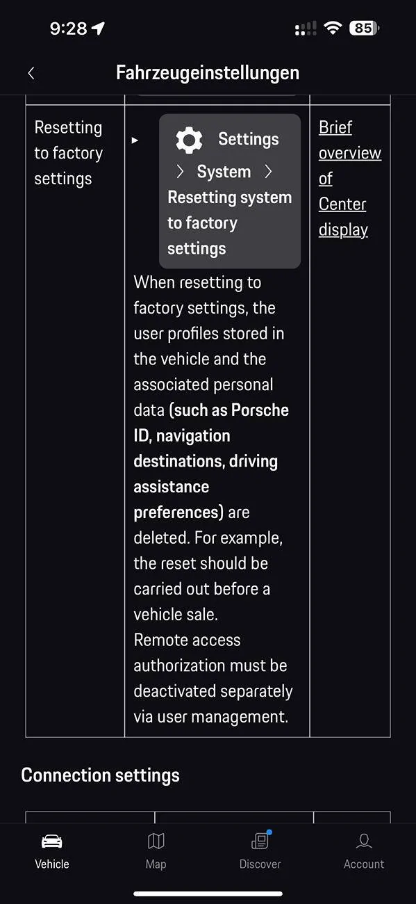

How do you do the reset from home?
krishmd
Sep 13, 2024
Chicago
macan 4
It was in one of the settings pages. The service guy was in the car with me and he didn’t use anything special ( equipment or codes)
It could easily have been done from home , but I wouldn’t have known about the waiting, since it wasn’t operational immediately. I got the car washed and about 30 minutes later we tried and it was operational.
Be careful, if you reset at home you may lose your manual in your PCM. This is something that will need to be reinstalled at the dealer. It happened to me.
any idea where in the settings…? Would save me a trip to dealer
