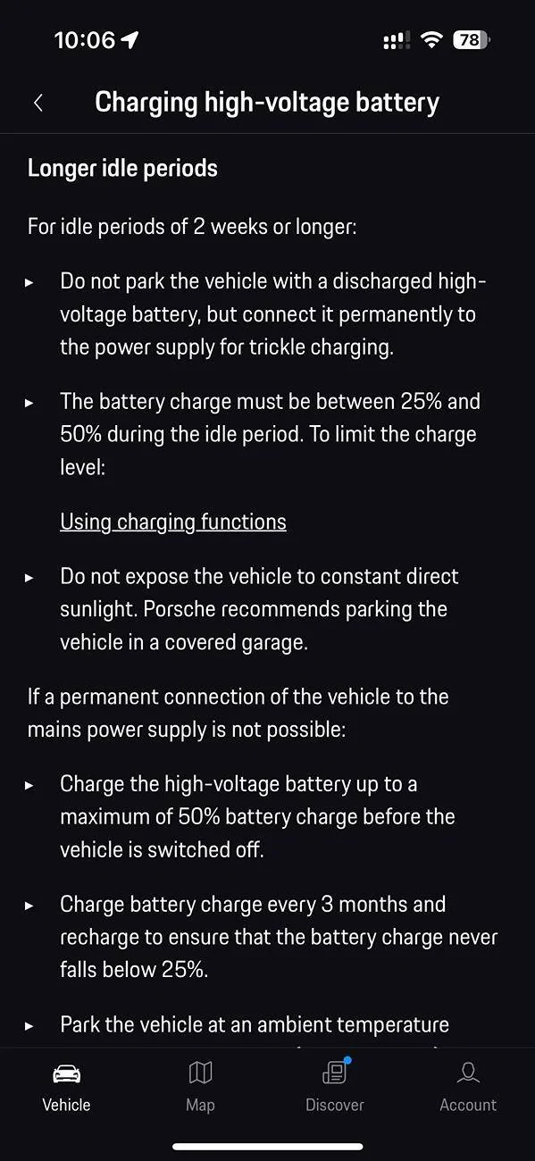

An engineer at Porsche, who appeared to be very knowledgable, told me to keep it plugged in with a maximum of no more that 80%, and it will trickle charge my 12v battery.
SimonEV
Simon
Jan 2, 2025
48
United Kingdom
As per the manual, the System Battery can be charged when plugged in:
  • To trickle charge, connect the high-voltage battery to the mains supply.
