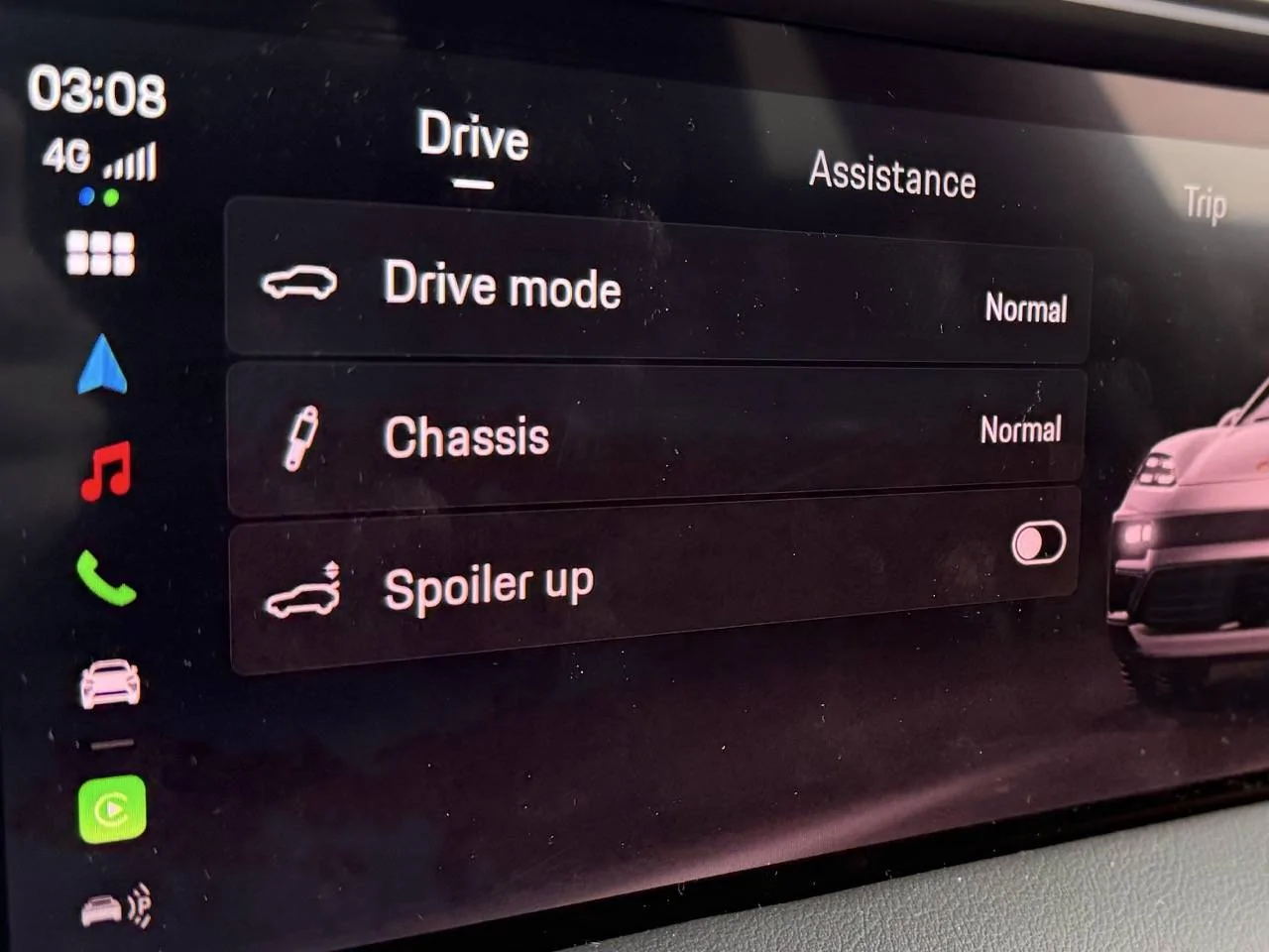

This weekend, I ran into a very odd issue: I am unable to choose the level/height of the chassis (Lift, Normal, Low, ...).
The information is gone both from the PCM > Drive screen and the instrument cluster behind the steering wheel (little icon on the right).
Electric Macan EV PCM doesn't display the Chassis Level option anymore IMG_1708
I can however feel the car adjust its height when I change the drive mode (Off Road vs Sport for instance) and pressing the buttons in the trunk, I can raise/lower the car as well.
Leaving the car for an hour and getting back to it didn't solve the issue, neither did a soft reset of the PCM (holding the volume button down).
I suspect it's just a software glitch but before I hard reset the car, wanted to check if anyone has run into this before.
