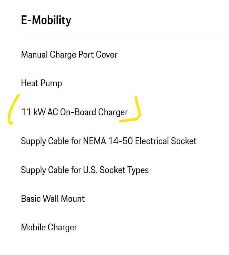

Standard Equipment on Macan 4 shows 11 kW AC rating (see below).
I checked newsroom internal docs and they clearly state "11 kW Integrated Power Box (AC)"
I will have a chance to drive one next week and will do a test at home where I have 48Amp output from Emporia EVSE charging my Taycan at close to 11 kW rate and see what Macan EV will report.
