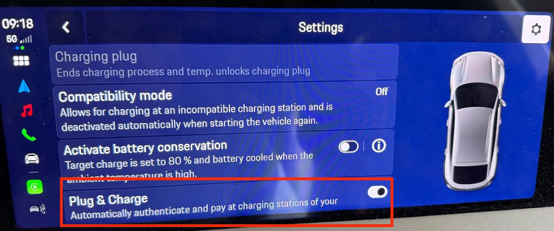

I believe we can delete the EA subscription certificate from the car. This will remove the Plug and Charge authentication that happens automatically when you connect the plug.
NOTE: This however would remove the P&C option forever...
you can simply toggle plug&charge "off" with out removing the certificate…see screen shot below from the charging settings options in my 2024 Macan Turbo EV
Electric Macan EV Have any of you signed up for an EA subscription post free period IMG_1196
this setting does NOT require you to remove/alter the charging account certificate…
in fact in my experience when I can not get plug&charge to function sometimes it's because this option is toggled into the "off" position for some reason…
once this setting is in the "off" position you'll need to activate your charging session via what ever mechanisms are appropriate for the charging network you're attempting to use - in my experience I've had success using:
  • myPorsche app charging service/map charging interface to start a charging session - even with plug&charge disabled you can still use the myPorsche app to start a charging session at supported charging networks (EA, ChargePoint, Tesla, EVGo)
  • EA app or Point of Sale card reader on the charging stall
  • Tesla App or via the "tap2pay" reader on V4 Superchargers (V3 has no tap2pay support)
  • ChargePoint app
  • other non-Plug&Charge charging networks
even if you remove the certificate it can be reinstalled, although the process is overly complex and requires patience…
