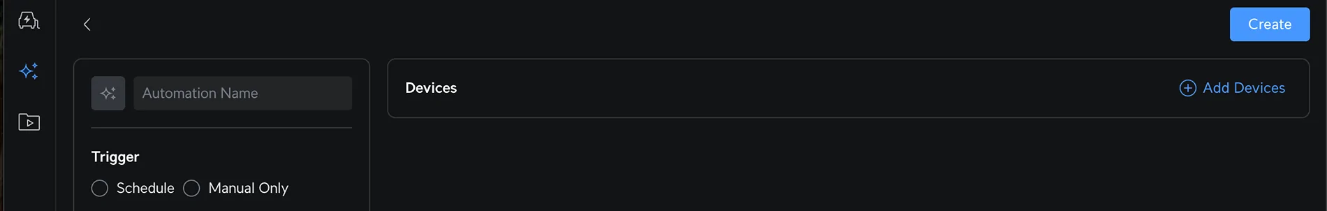

I've setup 3 of the unifi EVSE chargers at family residences, and they are great quality... but been pretty lackluster in automations and control.

Automations are available , have you looked into that?
